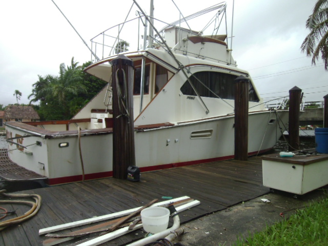

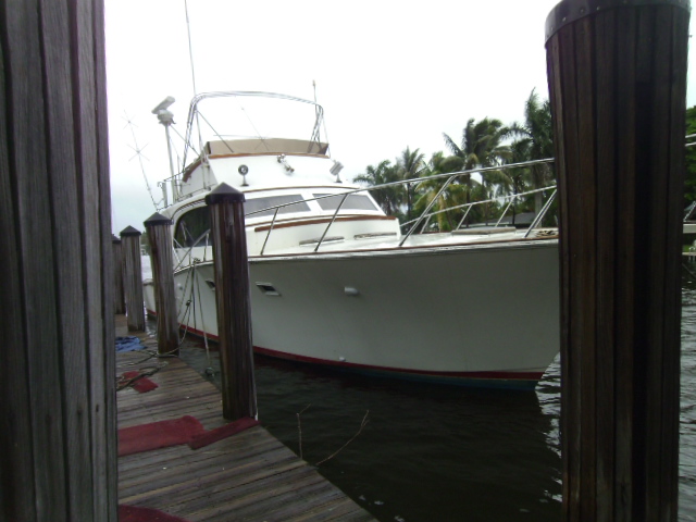

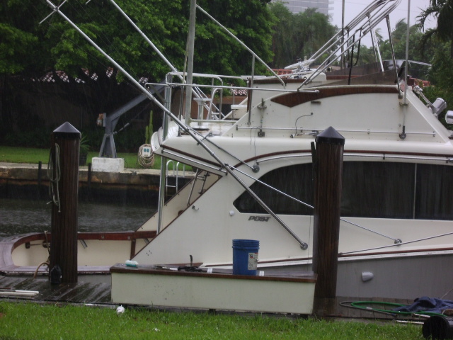

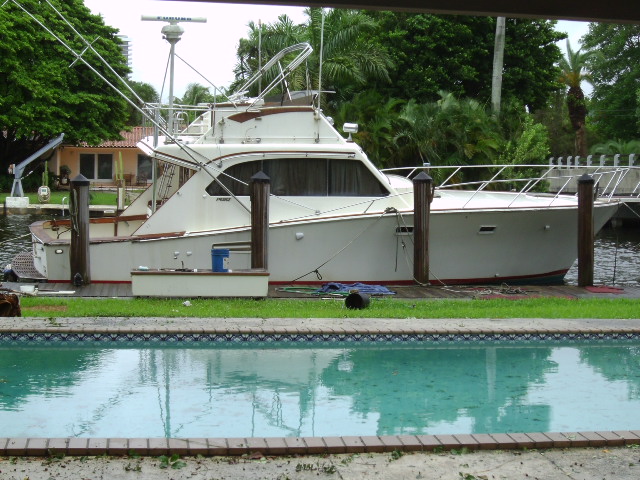

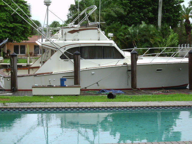

    just bought a 1981 post 42 sportfish got great deal but needs work
    1 engine is apart the other runs well she has jt 6-71 ti 410 hp reman by jt with under 300 hrs im working on rebuilding port motor due to old owner not tightning the raw water pump plate and water leaking and getting sucked in thru turbo motor locked up so basically a rebuild will be done anyways another long project lays ahead QUESTIONS fuel burn ?? cruising speed??
    wot speed ?? wiring diagram ? expected engine life at 410 hp ?? boat came with military injectors????? m95 i belive r injector # i think ant help on this one would be nice thanks in advance alex

    Congratulations.
    Looks like it does need some TLC.
    Who took the engine apart, you, or the PO ? Just wondering.

    thanks for quick replies MOTOR WAS already taken apart by PO boats been sitting for over 10 yrs running motor & generator fired right up clean & no smoke
    motor sounds rock solid & generator runs great under full load ( rebuilt by previous owner- boat was a one owner open check book boat before owner fell ill & left sitting interior needs tlc rotten kitchen counters & cabinets
    and master stateroom has water intrusion from upper deck so some rot there too i will post new pics of interior soon thanks for quick response
