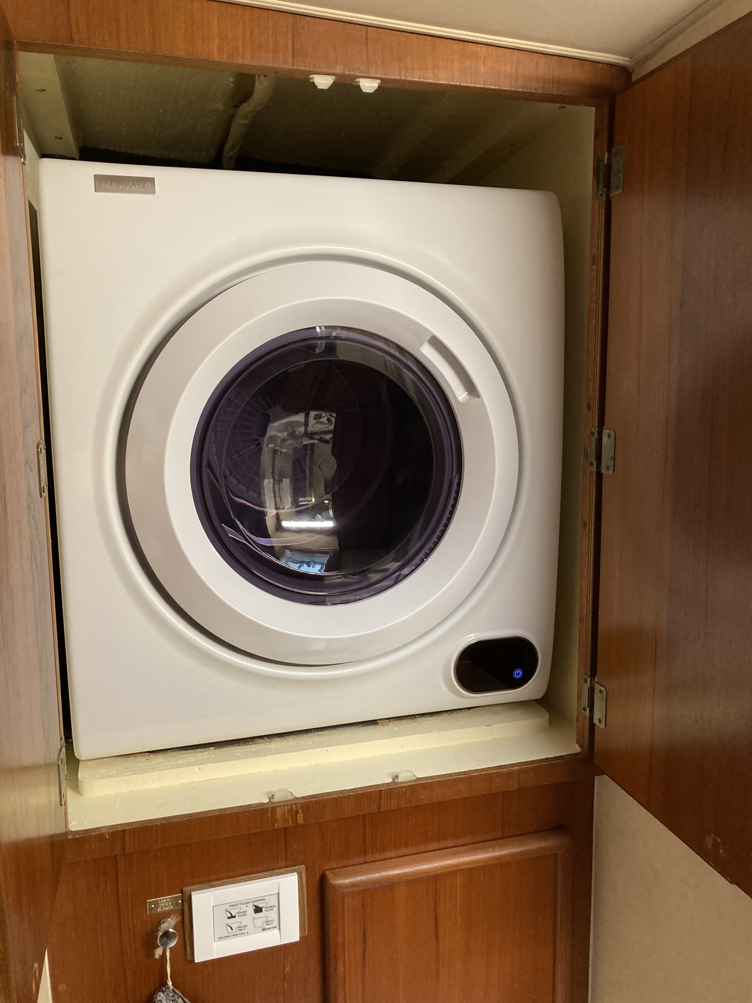

    New dryer installed. Turned out to be pretty easy, the limit was finding a unit that would go through the doors. Master door and to head are 1/2" larger than going through guest and needed the extra. Didn't remove cabinet doors but in retrospect probably should have for a touch more room getting into the cabinet.

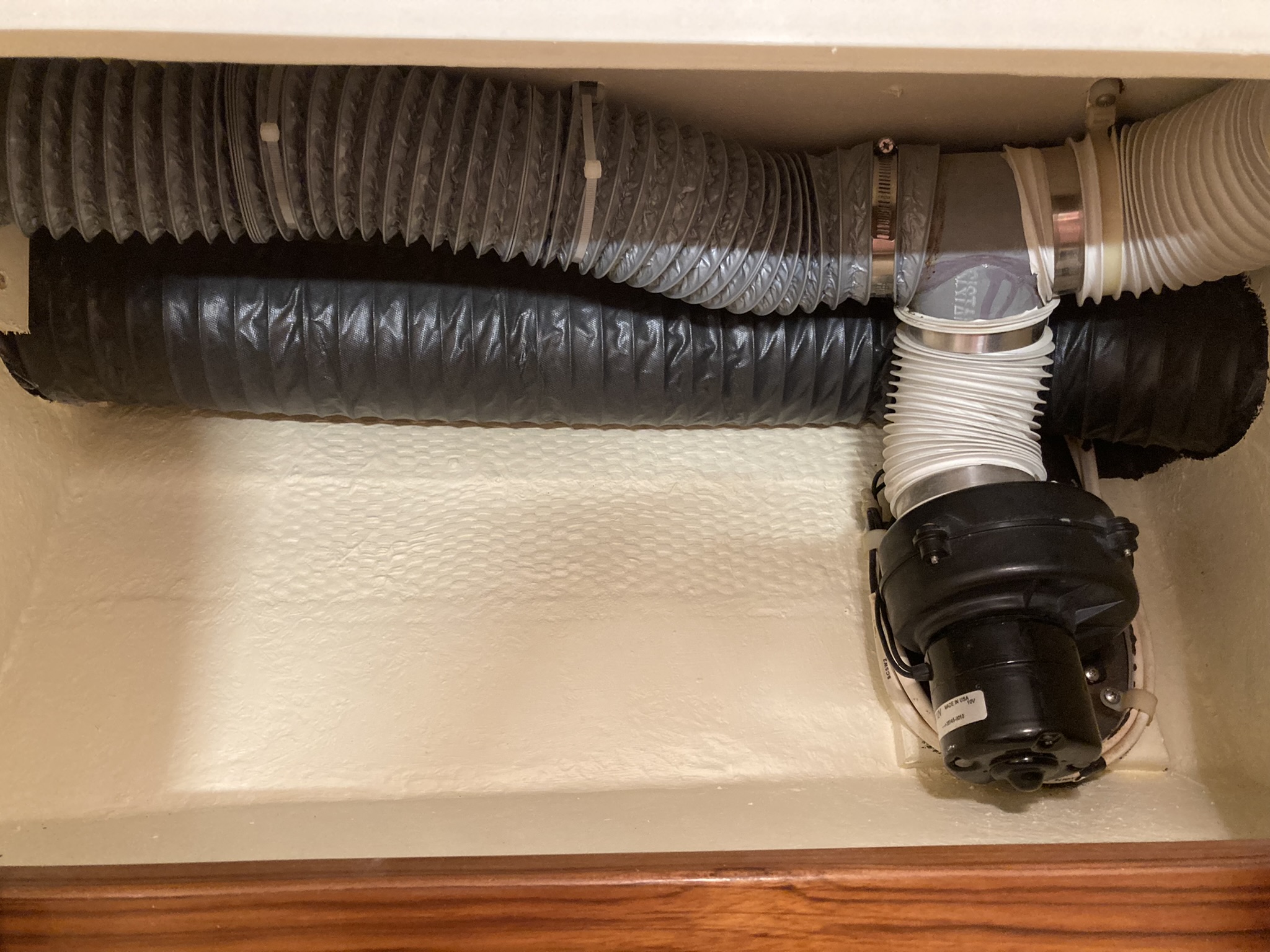

    Nice. Is it vented?

    Yes.
    The original was not vented, but there was a duct from the head shower vent fan into the dryer cabinet to make it "semi" vented. The new one is vented and uses a duct to the head vent and out the side of the hull.
  17. Capt Ralph
    12,727
    So, if the blower is not on, some, lots or most of the hot air goes back to the head?

    I have a backflow damper on the way that will go behind the shower vent and close when the dryer is running.

    I did the install. Was fairly easy as used the existing power outlet and modified the existing exhaust air ducting. It is a tight fit to get into the cabinet where prior unit was (it had been removed long before we obtained the boat) but unit is light enough to carry and install with one person.
    Unit is 2.6 CU FT Euhomy from Walmart (also available on Amazon). It had many good reviews and was also recommended by one of the online Best Reviews websites. It was one of the several units I found that would fit through the cabin doors to get to the head, and through the cabinet entrance (although if I did it again I would remove the cabinet doors for a little more room).
