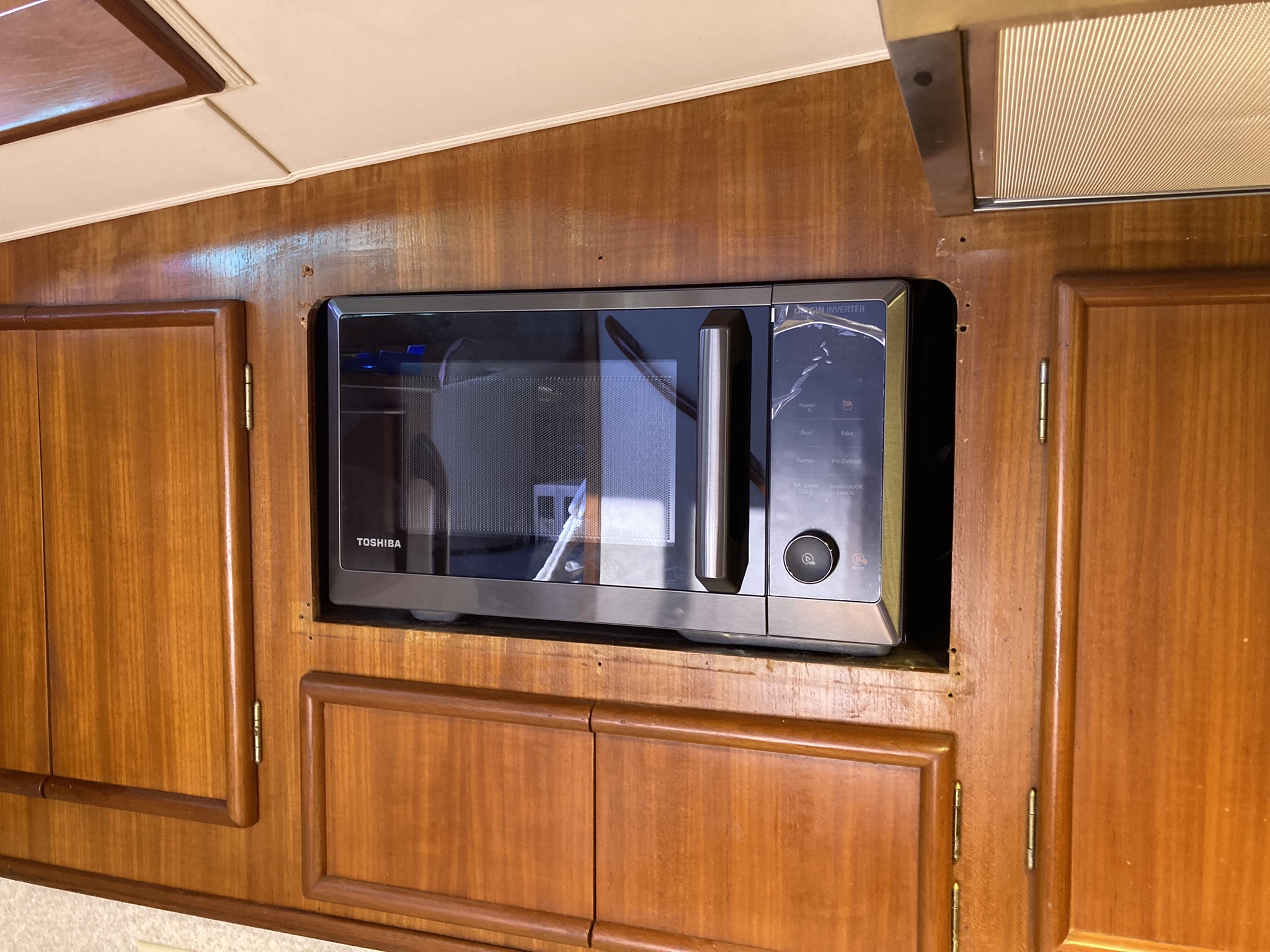

  13. Greg Page
    Greg Page Active Member
    Mar 4, 2017
    387
    Annapolis MD
    Test fit. It has 4 holes near the feet which I'll use to bolt it down from underside of the shelf. Might open up over the op a little. Will keep ends open for airflow since this unit has convection oven, air fryer etc. Will need to plug old trim screw holes and do some refinishing of the face.

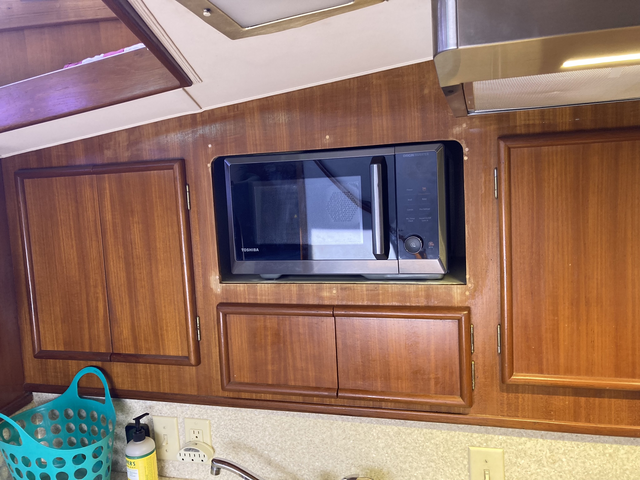

  14. Greg Page
    Mar 4, 2017
    387
    Annapolis MD
    I haven't refinished the plugged holes from the PO's monster trim screws yet but it is bolted in place using #8 self tapping sheet metal screws into existing holes on the bottom of the unit.

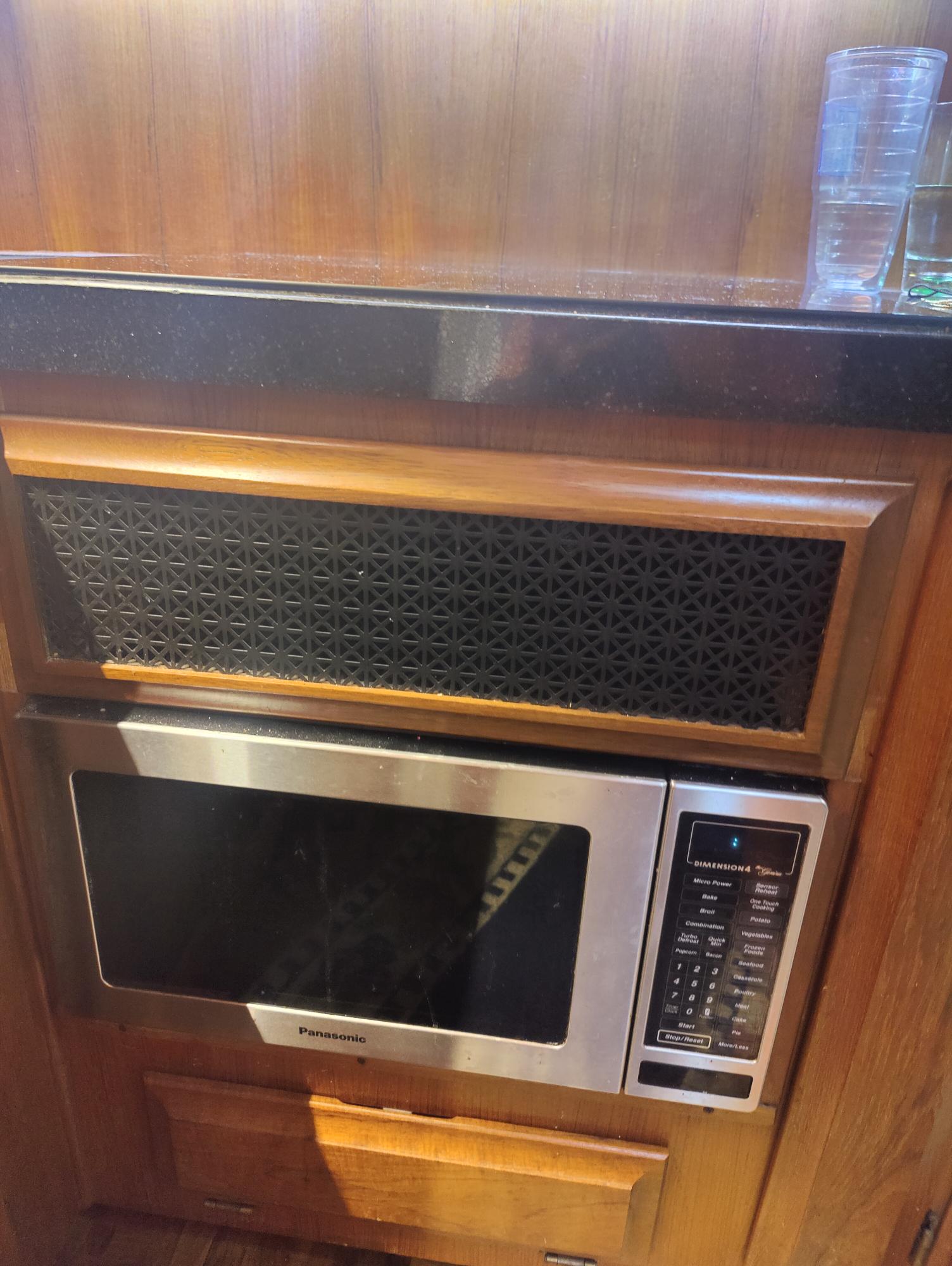

    If that is a convection oven, I would strongly urge you to provide as large an area as possible above your installation for venting. You will definitely have a heat issue without it.
    I'll post a picture of mine once my wife finishes cooking, the air coming out of mine is about 90 degrees.

  17. MBevins
    MBevins Senior Member
    May 23, 2008
    1,162
    Windsor On. Canada
    Yes, mine's a nice decorative metal screen, painted flat black with wood trim.
  18. MBevins
    May 23, 2008
    1,162
    Windsor On. Canada
    IMG20220815114943.jpg Here's mine.
    You can't see it in the reflection but there's actually a cooktop on that surface.
    Greg Page and Reel Antsy like this.
