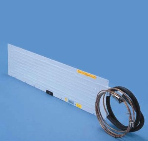

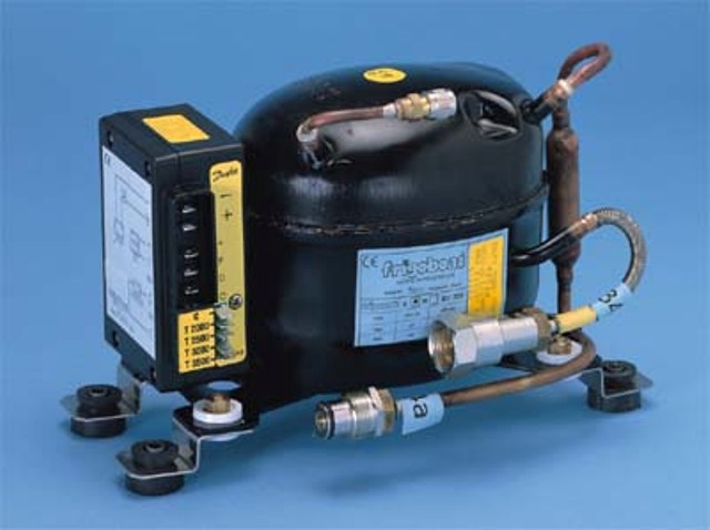

    Frigonautica or Frigoboat (.it)

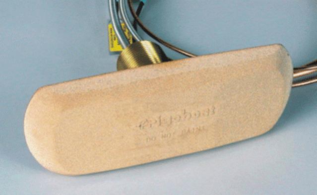

    I can only fully agree on that brand. They also provide fully custom cooling and deep freezing lockers and top loading boxes. The heat exchanger plates can be formed to suit the space available. To safe even more energy, the 12 Volt or 24 Volt DC compressor can be water cooled via a little heat exchanger (keel cooler). This makes the compressor very silent (plus possible remote mounting), low on power consumption and very long lasting. Great stuff, very usefull and available from little sailboats up to Megayachts. Should be available through marine shops or the web in your country. The keel cooler can also be used as ground or earth for lightning protection and as a dipole for your electronics. For Aloy or steel boats, they have different types of heat exchangers available.

    Hi,thanks so much for the advice, I was hoping to find a fridge freezer that looked like a domestic unit but made for marine use,does such a thing exist ?,sounds like a build in water cooled is the way to go, as I would be starting from scratch would the keel cooler be best?

    With the keel cooler you will have a close circuit, virtually maintenance free system, where no salt water is entering the boat. On a GRP boat it is the easiest way to go. A guy in our yachtclub here in Hamburg has converted his household type AC fridge to a 24 Volt DC system using the above components.
    The only external help, he needed, was the recovery of the condenser fluid in the old system by a professional mechanic. This fluid is concidered harmfull to the enviroment in Europe and by law can not be released into the air.
    This systems do not neccessarily work only as a cold plate system, they can be used as a normal fridge or as a deep freeze. The size of the compressor (and its set speed) and the condensor plate just has to reflect the size of the cooled space.
    This type of DC powered free piston type oscillating compressors last forever, if they are correctly filled with the fluid and the circuitry is properly installed.
