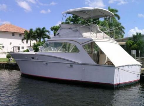

    Here is a picture of our Post very excited about the prospect of being boat owners for the first time hope we have not bitten off more than we can chew.:rolleyes:

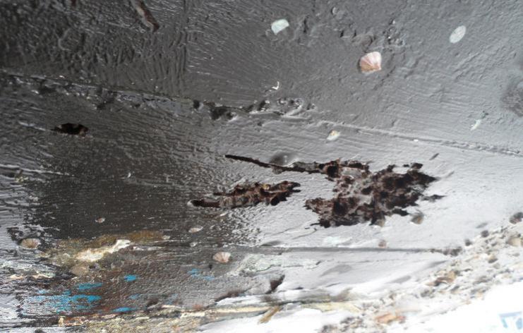

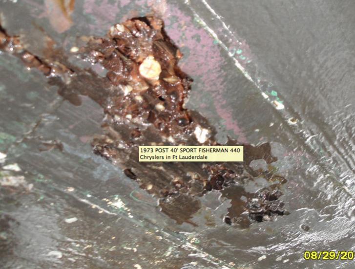

    These are the shots of the hull i have to hand if anyone can give me their opinion on how bad it seems that would be a help.

    If it was my boat that plank would certainly be replaced.
    Get a surveyor or a boatwright to inspect and sound the bottom,especially the butt blocks and garboards. If the condition of that plank is just an exception compared to the rest of them you may get off easy.
    Whatever course you decide to take remember that the bottom of a boat is everything and it's structural integrity must be in excellent condition.
