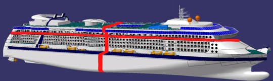

    Approach applied to larger vessels
    Sorry in advance that this is not really about yachts,
    but you may all be interested to know that this approach is being used in a large design office. It is not really the creative part of design , but more the conceptual engineering part.
    here is an image of a fully parametric panamax (note folding bow) cruise ship, they cna easily add extra decks or lenght by editing some parameters.
