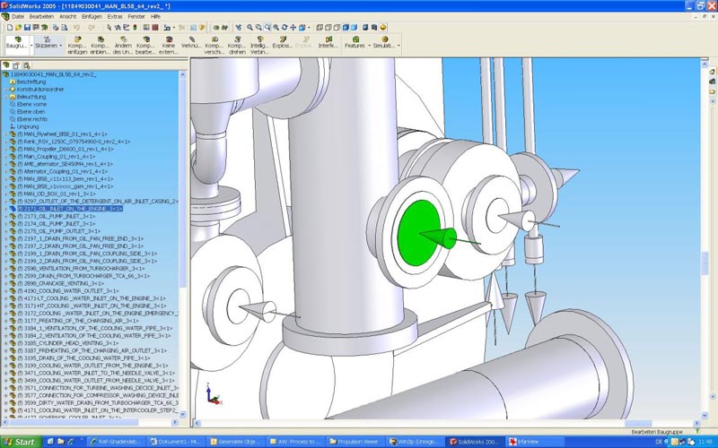

    For a long run we would like to integrate the equipments into a PLM process, there you need the full control over a very large assembly with names and attributes. Thus seems possible with UG, Catia, ProE, SolidWorks, Inventor but not with Rhino or Microstation or did you have other experience?
    Here I show you a Feature Tree in SolidWorks. How looks it like in Microstation?
    Cheers
    Bernd

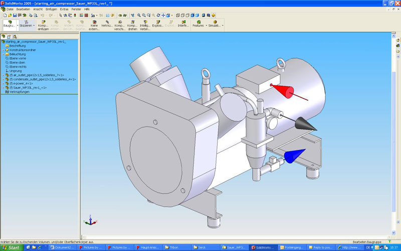

    It would be great if you could do a test with MicroStation for me.
    Please go to
    http://www.archnav.de/Sauer_Marine_compressors_rev1_.pdf
    then go to page 4 download WP33L, open the .x_t file with MicroStation and take a screenshot of the Feature Tree and and the model, post it in the forum.
    It should look like this.
    Cheers
    Bernd

    Hi... Well opening in Microstation is possible editing may be a problem as you stored it as a cel. so if you drop the cel you lose all the attributes. Also.. this was this really modelled in either solid edge unigrafix etc.. So picking it up as a dwg is not the best way to export it to microstation... But would be interesting to see just how good the conversion could be .. I'll pm you my mail account perhaps you can send the original..

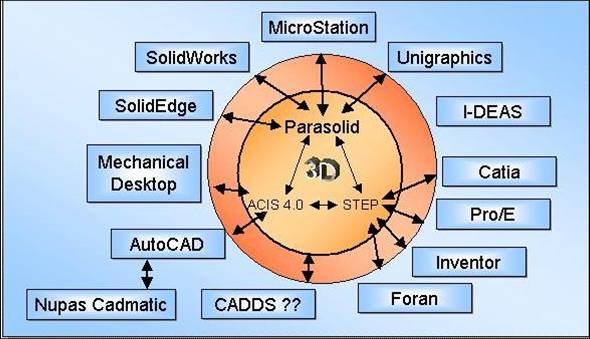

    Thank you very much for your comment and test. I don't understand your remarks up to now. The .dwg format is only for AutoCAD and the convertion towards Nupas-Cadmatic. For Microstation you should use the Pararolid format .x_t. Because Microstation is Parasolid based like UG, SolidEdge and Solidworks. If you do so is it then possible to view the Feature Tree and the names? Like it is possible in Inventor, Catia, ProE, SolidWorks etc.?
    Cheers
    Bernd
