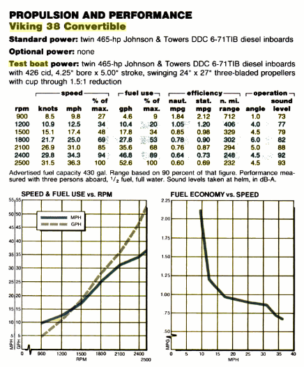

    Here is one sample of a boat test for your Viking:
    A light factory boat did 36.3mph at WOT and looks to be about 33mph at a max cruise of 2300 rpm. For longevity sake, I would not cruise them much more than the 31 mph at 2100 rpm. Keep in mind that these old magazine test boats where light and had no owner's gear or equipment to speak of.
    Is 40 mph at WOT possible with QSC's rated at 550hp and the weight savings? I would tend to say yes (just barely) based on inspection of these numbers, but the key is how heavy has your boat become? The best thing you can do is do an inventory of all your boat gear, keep all necessary safety and spares, get rid of as much unnecessary inventory as you can and start from there.

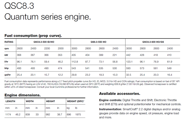

    Looking at the QSC 550:
    I see that the QSC 550 is a 3000 rpm engine. The Detroit's were 2500 rpm engines with a 1.5:1 gear ration > 2500/1.5 = 1,667 shaft rpm. So for the QSC 550 > 3000/1667 = 1.80 Gear ratio to maintain a similar level of propeller size before accounting for additional horsepower.
