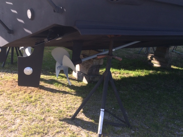

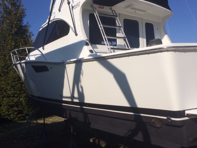

    I had a similar issue with my Luhrs, in terms of rolling, especially at higher speeds (20+)when on plane and therefore more hull was out of the water. In addition to that, my 390 Gallon fuel tank is directly under the cockpit adding to the weight in the stern.
    Running full tabs, took a long time to get the bow nose down, only at good speed.
    About 10 years ago, I installed the Fast-rails on my hull (now called Smart Rails - M-3000).
    https://www.integritymarinecorp.com/smart-rails
    Simple glue on installation, one rail on each side, near the stern of the boat. They create sort of a mini side tunnel on each side of the hull. After install, no maintenance -just bottom paint them just like the rest of hull. I no longer need to run full tabs to get the bow down.
    Not inexpensive, and I felt like a guinea pig at the time, but they have worked excellent for me in terms of raising my stern, and increasing lateral stability - by eliminating the rolling at higher speeds.
    Here's a couple of yard pics, take a look at these, if you are considering options.
    P.S. You also have to be very vigilant in the yard to make sure the Travel-lift is either blocked around or not in the same area as the smart-rails. I clearly marked my sling area, and always make sure the yard knows about these rails prior to any lifting.
