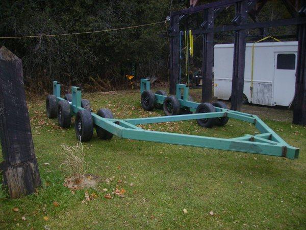

    what I have is a stripped down hull with motors and trans .
    I made a trailer for it and was wondering what kind of wheel loading i was looking at.. I feel that just the motoers and hull are no more than 6000 lbs
    there is ALOT of weight in all the accesories ALOT.
    I intend to build up with just bare min at first see what knid of performance i get.
    I trailerid it accross a fiield and was supprised how easily it towed quite light.

    Here is trailer with removable truck assemblies can be 4 8 or 12 wheel
    works wonderfully. very pleased.!
    Saves lots $ moving it around

    wow, that trailer is very impressive! That is great to be able to move a boat of that size and not have to call a boat transport service to do it. Nicely done.
