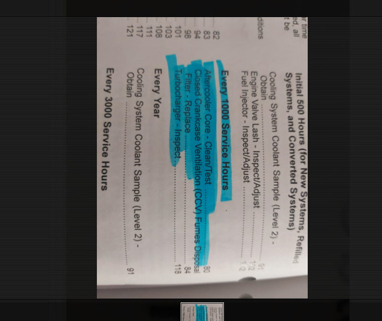

    Hi all.
    I am a yacht captain aboard a yacht with Cat 32 engines.We last removed the intercoolers and had them pressure tested in 2016/17 @hours 527 hours at a cost of approx 7000 Euros each engine. Service and removal and pressure test was 10,000 per engine.
    The yacht is 9 years old and now has 750 hours only. Engines from 2010, yacht was launched in 2011.I asked Cat for a quote to service the engines this year and I was informed that the intercoolers need to removed and tested again after 225 hours again they are asking 10000 each engine for service and removal of the intercoolers.
    I know Cat has issues with previous models but i simply can not understand why they are asking us to do this again at such low hours. When i ask them to explain why.. i am told that Cat ask us to remove and test every 2 years or replace every 6. When my engine Operation and Maintenance manual quotes ....every 1000 service hours> aftercooler core clean/test. nothing is mentioned about removal and test every 2 years or replace every 6.
    I simply cant understand how Cat expect us to pay 14000 every 2 years ..7000x 2
    The engines are not under warranty but i still use Cat as i want the best service possible. Every year they are serviced, oil and coolant samples taken etc.
    I simply cannot understand these costs..!!! I need facts before i inform my boss he needs to spend another 20000 on the engines. I have asked Cat to explain why but nothing fore coming.. would anyone have any info? or have a contact number so i can speak to someone who can explain why? I have been a captain for 15 years and have never had to spend so much on engines!!!
    Thanks all.!!

    Manual is dated November 2009

    Cat had an issue on the original C32 aftercooler design and came up with a redesign. I ve been running a 2009 84 Lazzara with C32s for almost 4 years now. I found the boat for the owners and the first thing my local cat guy mentioned when I asked him to survey the engines was that the AC would have to be upgraded. We did it after closing the deal (about $16k per engine) and haven’t touched them since. That was over 1500 hours ago.
    it seems to me that your local dealer is looking additional business. :)
    before the current boat I was running a boat with 3412Es. Put 4000 hours on her in 8 years, I think we cleaned the ACs once

    I spoke with another dealer in the uk who just mentioned ...that you should test or service every 2 years or replace every 6. But not at no where near the cost at which i am being asked to pay. Just a note..if the Intercoolers do fail is game over for the engines or at the very least engine rebuild..awesome design CAT!!!!!

    I was aware of the 6 year replacement recommendation but not testing every two years. Sound a bit extreme... hard to believe Cat can’t make aftercoolers (not intercooler BTW) last more than 6 years...

    A lot of Cat owners are questioning the maintenance schedule. My manual for 3406E and C15 engines updated 4/15/2015 states aftercooler clean and test at 15,000 gallons, or 1,000 service hours, or 2 years calendar time. Replace every 6000hrs or 6 years. Not sure if the same as the C32. I question this because of what you stated, low hours over the 2 year clean and test period. Average time for recreational use is way less than 1000hrs. in 2 years. Was told by a Cat mechanic the warranty program was the reason for the schedule. Adds a lot of expense when you amortize cost for cleaning and replacement over 6 years. You need to check for updates on your Cat maintenance schedule, it maybe different than original.

    If your aftercoolers are original, have them pulled and CHANGE them with new ones. CAT recommends changing them every 6 years. I've seen them fail, once even on a 3 year old yacht with the new style C32 aftercoolers and causing a rebuild. I don't think I'd inspect/pressure test them every 2 years, I WOULD just pull them every 6 years and replace them with new ones.
