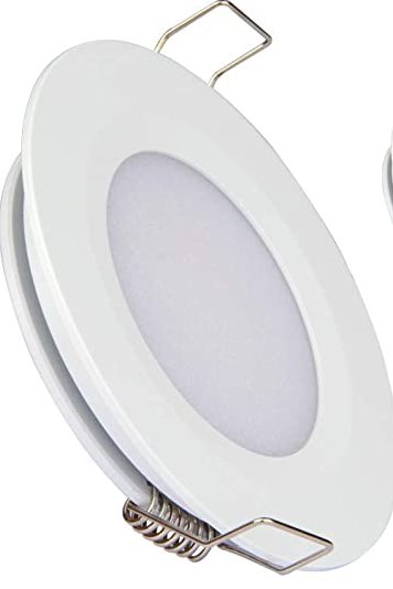

    Anyone know of source for these approx. 2" flush mount LED's in 24v dc ??

    The spring mounting on the fixture looks similar to the DRSA "L'il Inagua" models (although latter also swivel slightly, inside a satin/nickel bezel).
    If indeed an older DRSA product, the fixtures were not originally LEDs, but the original halogen or xenon bulb can be replaced with an LED. In our case, the LED replacements are a 10-30VDC back-pin G4 from marinebeam.
    And in general, LEDs from marinebeam (and probably other reputable makers) are often 10-30VDC intending to deal with either 12V or 24V while also allowing for sloppy DC voltages in a marine environment.
    -Chris

    DRSA or Lumitec maybe. I don’t like LED fixtures as you can replace the bulbs when they fail. I prefer basic G4 fixture so you can replace the bulb.

    Two small wire crimps and fixture easily replaced. I think they look a LOT better then those with exposed bi pin bulbs.

    Hella made LED sealed ones that were 2" I believe. LED fixtures that look like that. I had the same issue and found them to work.

    That is what I have wondered about folks changing the fixture instead of just swapping the G4 pin type. I sort of get it, in that I can see the LED light emitting chip through the frosted glass in my OEM fixtures. Doesn't bother me so I just kept the fixtures and replaced the "bulbs". I am still amazed the original 10Watt halogen bulbs did not melt more ceilings, those suckers are H O T.
    I would look at IMTRA
    https://www.imtra.com/products/product-search?producttypeid=504&filterBrand/Category=Downlights

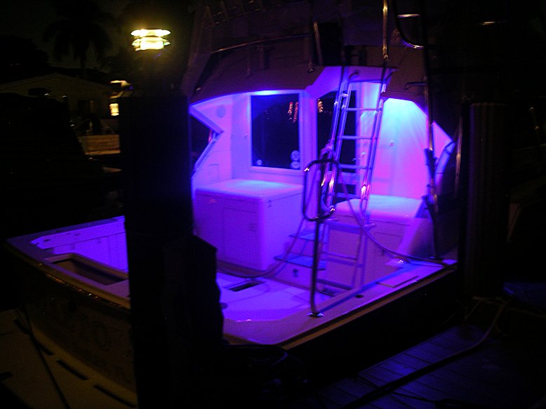

    In reviewing this thread, thought I would add; a buddy in the boat business informed me he had heard the old quartz "heat lamps" were found to be cause of several head liner fires in a popular mass produced brand of boat he used to sell.
    After failing in a search for a specific type of blue 24 volt LED's for a couple exterior surface mount fixtures I recently resorted to changing the "sockets" to accommodate the LED's that are available. Someone had suggested using a Sharpie to color the available white LED's and that actually worked, for about 2 weeks, and despite little use, the blue turned white again.
