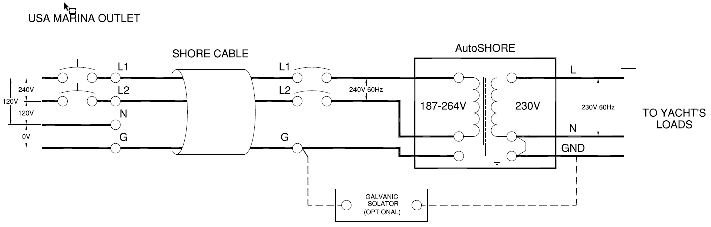

    Gents, here is the wiring image001.png diagram recently obtained..As Neutral is not bring used ,I have concerns a gfi circuit on the marina box may fault

    Dockside GFI can’t trip when using an isolation transformer since neutral isn’t used.
    that said, if you have this on the boat, then you should be all set as it is outputting the euro 230v you need

    This isn't quite right, in USA there is no neutral for 240Vac split phase. The 3-wire conductor will be L1 L2 GND to the load. Shore supply uses 4-conductor with N only for the 120Vac loads on either leg.
    I've often supplied 240V split phase to European equipment labeled for 220-240V single phase L/N input without issues. As long as the frequency difference is acceptable, a transformer is not needed to power the A/C compressors and pumps. And if the frequency difference is not acceptable, a simple step-up/down transformer won't help anyway.

    ok,thanks for comment,but how do you tie the 2x 120v feeds to the 230 v 2 wire euro inputs?...

    Apologies if I've missed something in your question, but I'd connect L1 L2 to L/N and GND to case or green screw.
    Ensure your N is not connected to the main neutral bus if the rest of your power is single phase.
