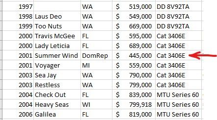

    Attached (hopefully) is a list that I compiled of PM 65s currently for sale. The Cat 3406E is appealing, so we're focused a bit on the 2000-2003 models.
    All these prices are reasonable and within budget, but the outlier is clearly the boat SUMMER WIND, currently located in the Dominican Republic. Does anyone know this boat and what might be behind this drastically lower price? More than simply the undesirable location? I'm thinking if we could get her in the low $400s, plus maybe $50-75k to have her moved up to Vancouver, that we'd be left with a nice budget for whatever updates/upgrades we'd like (and I'd expect that any ~20 year old boat will need some work).

  2. Capt J
    14,641
    I have run a lot of yacht out of Central American, Dominican Republic, and the Caribbean. You have several reasons for the lower sale price and it is common with all. If an owner has a good boat, they will bring it to the U.S. to sell. Used boats simply don't sell in those places.
    A. People are afraid of making the deal and having the asset in a foreign third world country. One boat dealer had a Captain fly down before the actual closing to be on the boat when it closed and wait for the additional crew so it could leave. Plus the cost to get it back. AND, it has to be very sea-worthy to even get it back. You have long legs of nothing but open ocean and no tow boats or anything like that.
    B. The climate is very harsh due to the salt exposure in most marina's in those places (just off of the ocean), and the sun intensity and heat being close to the equator. Gel coat/paint, cushions, canvas, interior wood work........etc. lasts less.
    C. The most important aspect. They are very good at cleaning in those locations (engine room, exterior, interior) and always have full time crews. I would not be surprised if that boat has had a full time Captain and mate since new. BUT, they don't know how to fix anything that breaks. So aside from engines, generator, and steering, generally you'll find many systems that are broken, island engineered to work, or any matter of stuff. Basically if anything remotely complex electrical fails....even simle stuff.......like a holding tank gauge.....it stays broken......At that boat's age, you're going to have pages of deficiencies on a survey from a boat down there, generally. NOW, if you can fix many of those items, then it may be a deal for you, but you need to fly down and inspect it.

    Wow, great perspectives and information! I probably initially underestimated the hassles associated with buying in a remote location, flying surveyors in/out, likely a long fix-it list, hiring a captain/crew to get the boat up to Florida or Panama for pick-up, potential damage during loading/unloading on a transport, etc. Might well not be worth it... thank you!

  8. Capt J
    14,641
    I wouldn't worry about the shipping part. You don't want to ship out of Panama, it just will not happen. It's not a normal stop, the port on the Atlantic side is expensive to load, and they'll book it and then drop the shipment 3 months later, just like they did with my customer. So it's either run it through the Canal and load in Gulfito, Costa Rica, or Fort Lauderdale, FL.
    It could be a stellar deal. I don't know how boat savvy you are, but flights to DR are relatively cheap (when this virus subsides), if you're extremely knowledgable, go down, look at the boat extensively, and test all of the systems, or bring a good Captain that can, then make an offer and survey it. It's already a very good deal, IF it's in decent condition. Could always tell the broker, you want to see it. Also how much extra for you to have his crew take the boat out with you for the day, and run it at cruise for a few hours, and test the systems, and you'll also pay for fuel. Worse comes to worse the boat is a dog, but you got to see a beautiful part of the Caribbean for a day or two.
    I wouldn't worry about the shipping part of the boat......I've done close to 1,000 freighter loadings/unloadings. It's very rare one gets damaged at all.
