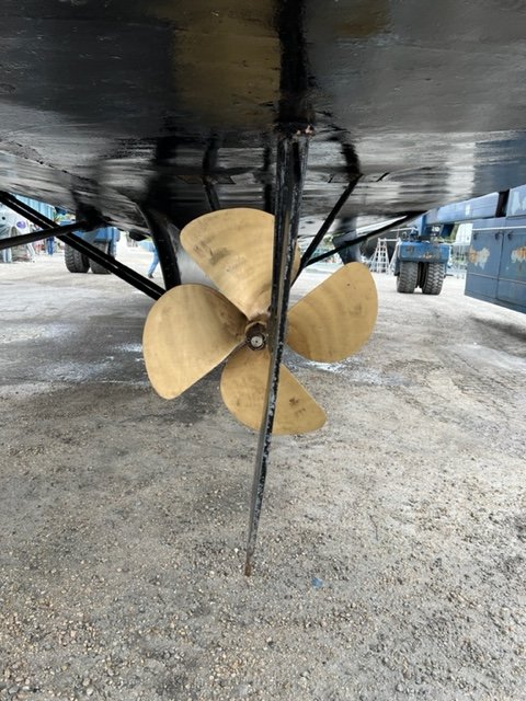

    1-There is a noticeable vibration at higher loads. So much so the flybridge Stidd chairs looked like those cheap vibrating chairs from the 70s you put a quarter in. This is really noticeable at full load with was about 18 knots. We ran it in the river, but later in deeper water where it was less noticeable, but still there. There was some discussion that it could be caused by swallower water, otherwise known as Squat Effect or Leonardo's Law, ergo the deeper water run to see if it would go away.

    What could be causing the vibration? I know about the typical thing. Although I have not seen the survey, our surveyor thinks the cutlass bearings are good, no noticeable prop issues, no motor mount issues. I did notice one rudder for some reason has a slight bend. The shafts and props where replaced in 18 I believe. The engines were rebuilt less the bottom end last year and have 240 hours on them since.

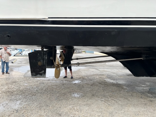

    So let me ask the following: Google and the forums say it can be engine alignment, shaft alignment, bent or worn shaft, worn cuttles bearings, worn rudder stuffing boxes, out of balance or bent props, or motor mounts. Were you able to completely rule out all of those items?
    Is it possible, since all was changed but the lower parts of the diesel that something is out of balance on the engine that the eye cannot detect like a crank? I know you looked at it and put your hand on it. Were you in the engine room when this was occuring? I think you were. I'm sure this was not the cause but I am trying to find out what was causing this. Consider this is a stupid question as I am totally ignorant on this and not an expert as you are.

    • STAINLESS STEEL 2.5” PROPELLER SHAFTS (NEW 2018) WITH 4 BLADE NIBRAL 34” X 27” PROPS (DYNAMICALLY BALANCED 2021)

    7-The rudder is bent. I assume there is no way something this insignifiant could cause this vibration. I know in the brokers description you can find here, it says the shafts were replaced. Why?

    Something is fishy. Why were the shafts and wheels replaced ? Why is that rudder bent ? A “rebuilt less the bottom end” is a half ass job...
    Vibrations can be expensive to chase down
    water depth shouldn’t be the problem unless less than 9’ and it would only cause a vibration because of cavitation while popping on plane especially if the skipper was heavy handed. I’ve gotten boats that size on plane in 8’ to 9’, gently, with no problem.

    That's a lot of unsupported shaft.

    Following up on Pascal's post, ask the previous owner where and when he ran it aground. This vibration is something they've probably already been chasing but haven't solved yet. And I get so tired of these supposed rebuilds followed by "except". Did it reach rated RPM at WOT? I doubt it.
    Vibration can be fixed for a price, but likely they've already tried so price is increasing to do so.

    Your motor might be sliding ever so slightly fore and aft on the engine stringers causing mis alignment. Had this problem on 73 ft kong and Halverson. Didn't see it until hard shifting into reverse while looking at motors. Chased tail for awhile. Boat has ghosts in my opinion. Grands weren't well built to start. I'd look for an outer reef first.

    Thanks guys for the input, that's why I like this forum. One would think with the bent rudder it did run aground or it sat on something somewhere sometime in its past. As for the shaft I agree that's a lot of unsupported shaft but then again I am not an engineer.
    He did stop and while he was in the engine room shift forward and reverse then advance the throttle to check the beds and mounts.

    STAINLESS STEEL 2.5” PROPELLER SHAFTS (NEW 2018) WITH 4 BLADE NIBRAL 34” X 27” PROPS (DYNAMICALLY BALANCED 2021) that the the bend rudder is odd. IF shafts new in 2018 why no balance the props then? Why balance them in 2021. The current owner hit something. This sounds very expensive and I would be out.

    Or, since the shaft & propeller replacements, from 2018 to 2021 fought with this vibration problem, then balanced the wheels that did not help.

    Some people believe in pulling and balancing wheels every couple of years, maybe that was the case
    2 1/2” shaft seem a bit light for these engines and boats and as Ralph said that seem to be a long unsupported section. Hopefully someone calculated the safety factor and used AQ22HS...
