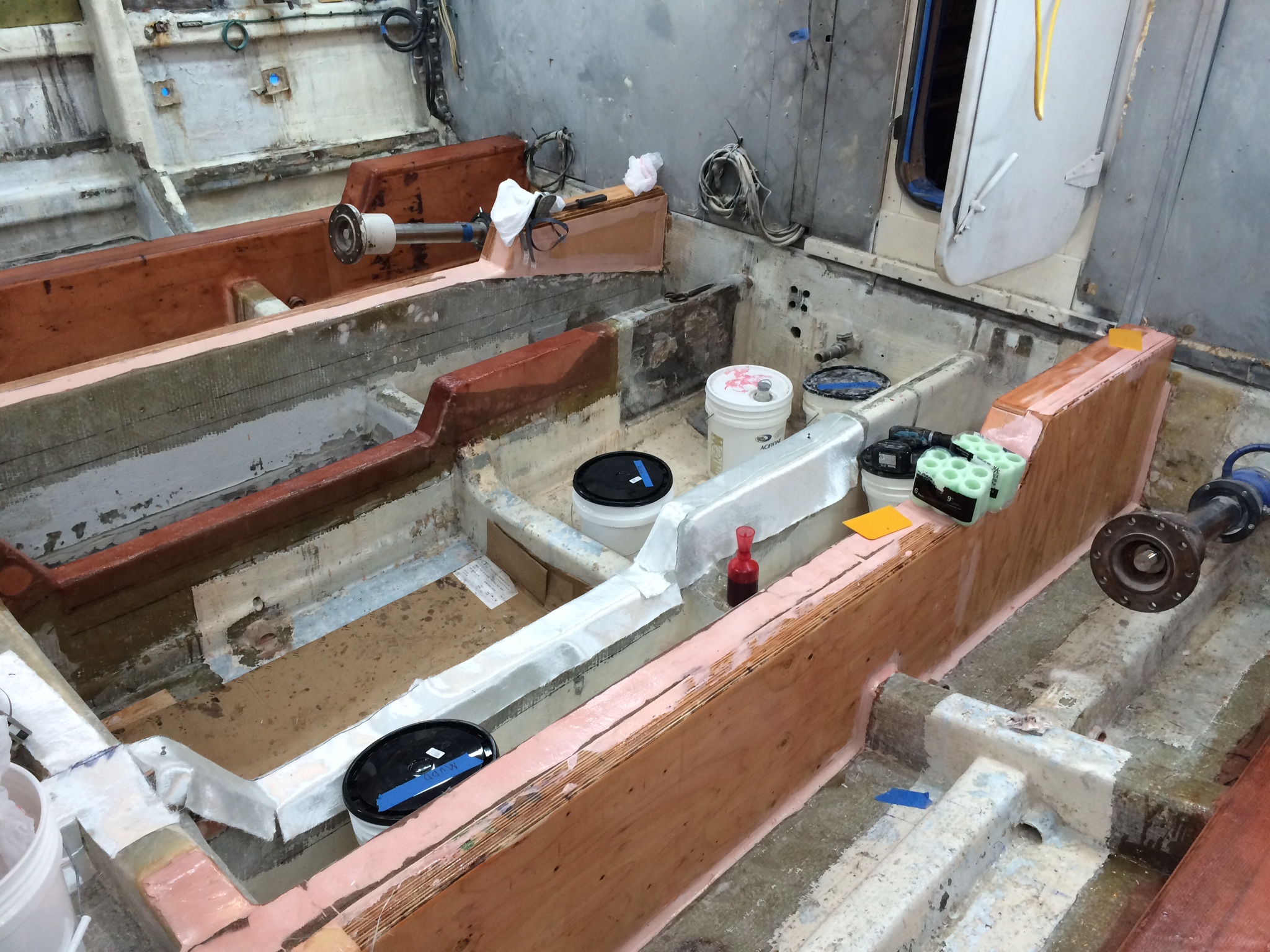

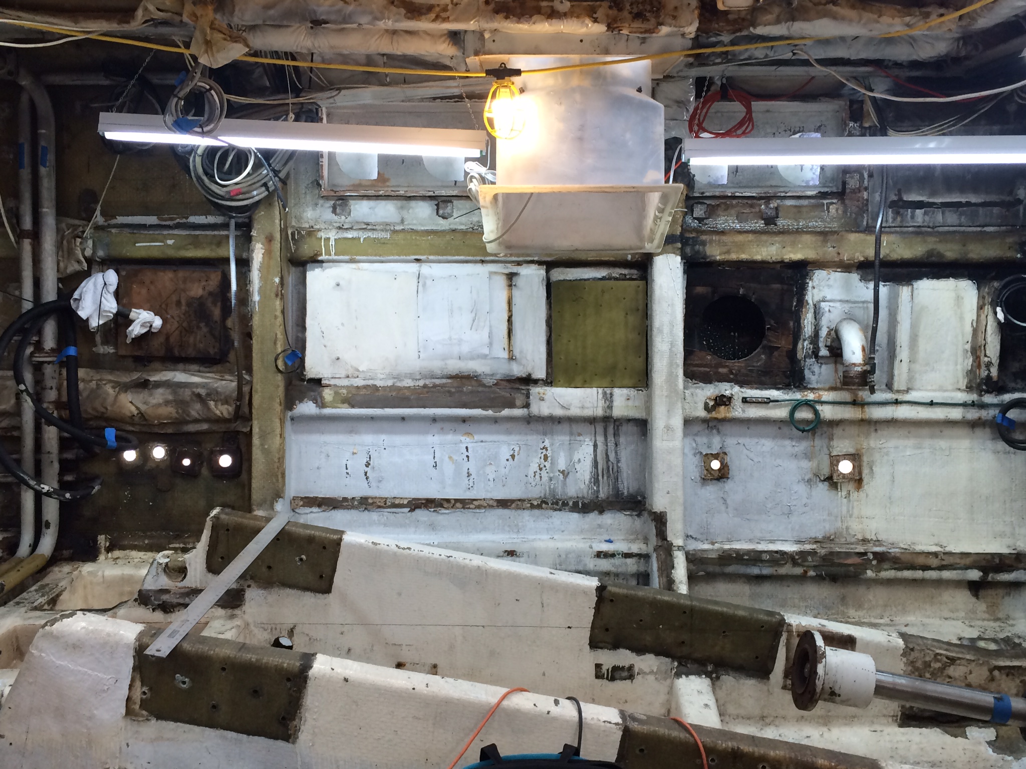

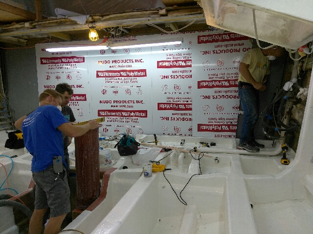

    Yes we did. I'm now a couple of months in on a medium sized repower that has the scenario listed above. Girder mods, drive line etc. etc. Rarely if ever will you be able to repower with a different manufactures engine package and keep your drive line angles from one to another and that's just the tip of the iceberg down the line for ancillary attachment's. $400,000 for the iron and another $500,000 for the modifications and putting the machinery space back together to pass classification IMG_0271.JPG (1).jpeg IMG_0271.JPG (1).jpeg IMG_0474.JPG.jpeg PART_1487036286505_IMG_20170213_141657.jpg survey.
