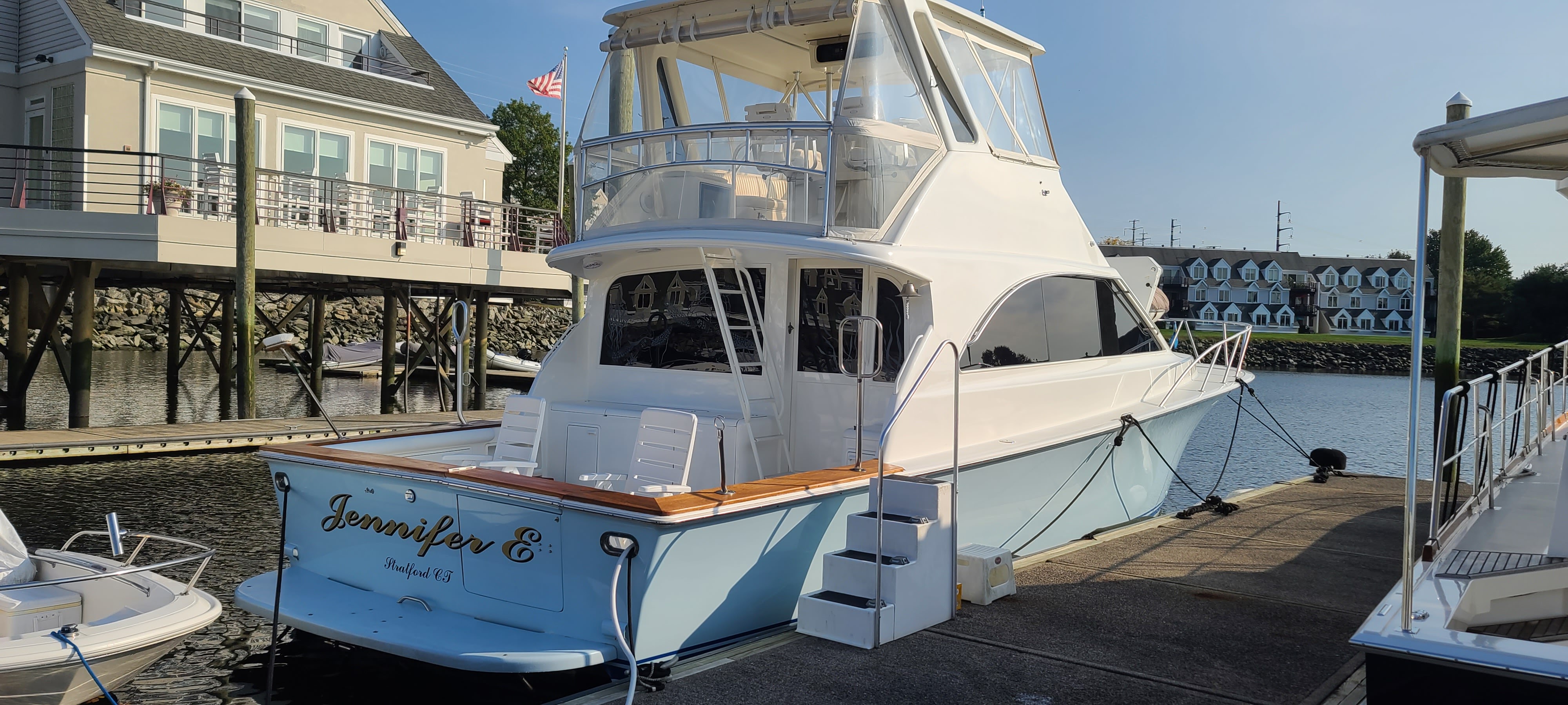

    20211015_152442.jpg Beacon point shelton for winter, caswell cove in houstatonic river for the summer
