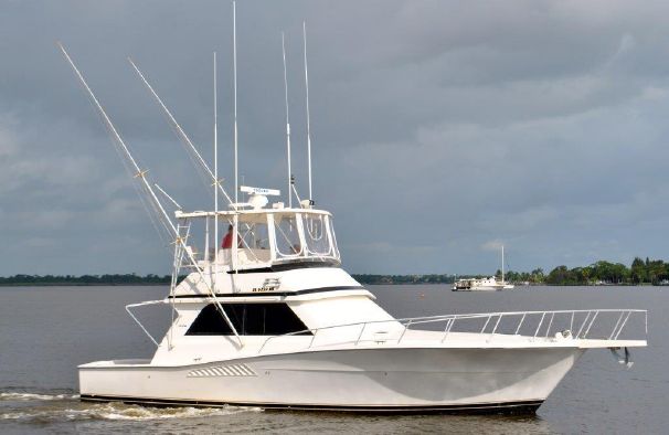

    Yesterday I sea trialed this boat equipped with DD 6v92 with 625hp each. It's a great riding boat but I was surprised at the performance numbers, they seem off to me.
    Going by the Furuno GPS onboard
    cruising speed was 17-18knts @ 1900rpm
    WOT speed was 21.8knts @ 2350rpm
    The sellers listing showed 26knt cruise and 30knt WOT
    Does anyone have any knowledge as to what the numbers should be on this boat?

    I purchased the boat and what I've learned so far is that the engines are not 625's. I have not found the injector numbers yet so I can tell the hp rating of the DD's. From the paper work from the factory it appears they are the 535's. I had the bottom redone and prop speed coated all rudders, shafts, props, etc. The fuel tank and fuel were polished. Now with a full tank of fuel (525gls) and being able to play with the tabs (she liked a lot of tab) I was able to get 20 to 21kts at 1900rpm and 25 to 26 at WOT 2350rpm. She rode smooth in a 2-3foot chop the engines stayed around 175 degrees when up and running.
    I am very happy with how she's running, fires right up, no smoke. She needs some TLC and the wife and I have been showing her some love. The sectional sofa is getting new skin, the floors have been polished, all new linens, new blinds, window tint and recovered bolster pads. The nice thing about this is that the wife and I love the water, we like having projects, we have a weekend retreat to go too, and we love to fish.

    Since I purchased the boat I have been doing a lot of cleaning up old wiring, upgrading electronics, new canvas, pumps, seals, LED lights, interior décor, underwater lights, etc. Just giving her some TLC. The wife and I took her out a couple of weeks ago for her first fishing trip of the year and managed a couple of small gaffer dolphin. We've been very happy with our purchase and have really enjoyed spending our weekends showing her some love. Attached are a few pictures of some of the progress.
