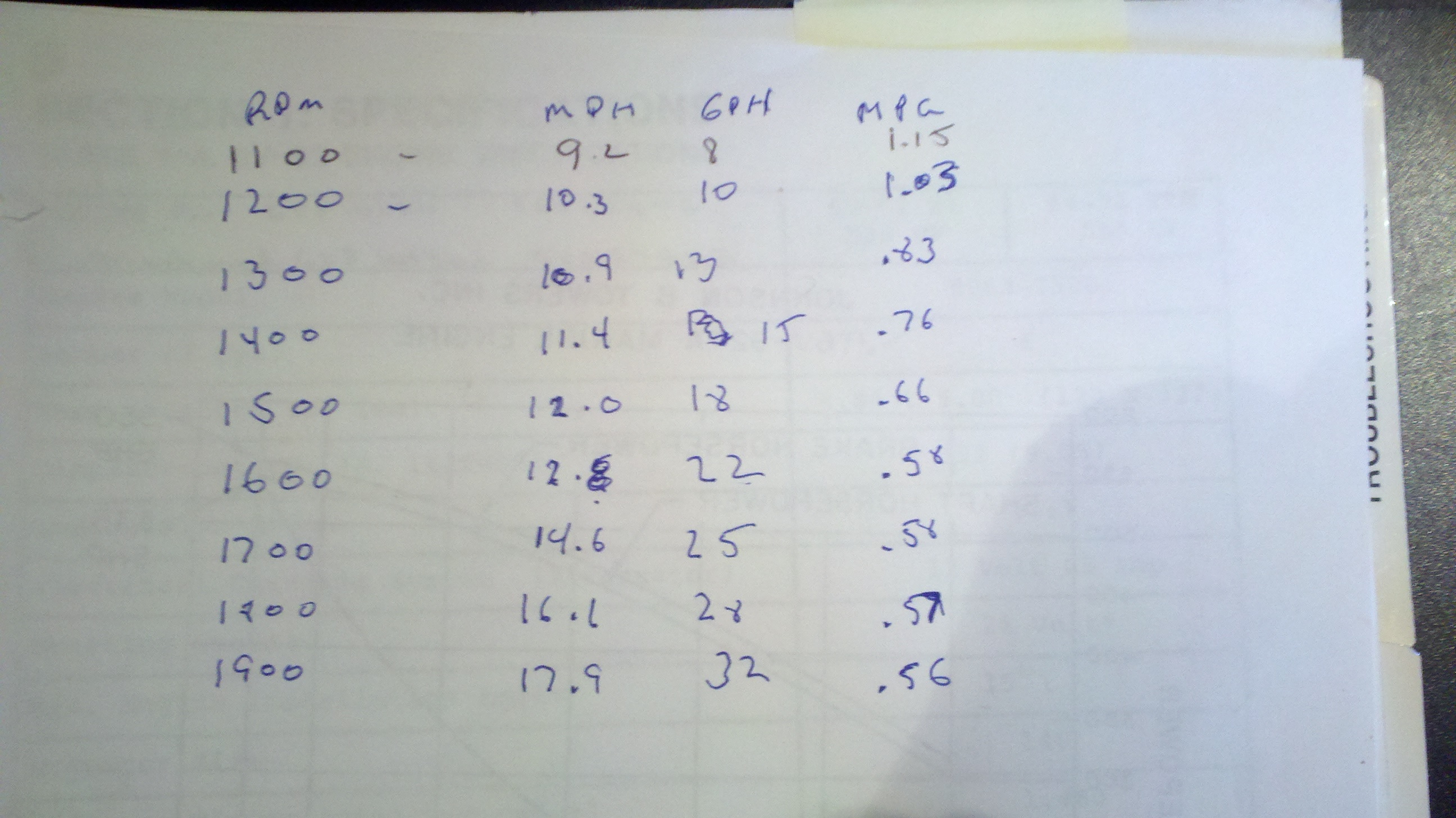

    Any ideas on Fuel Consumption on these 6V92's?
  9. SeaEric
    SeaEric YF Historian
    Jan 28, 2007
    1,362
    out on the dock
    This is a fuel chart of actual numbers from a customer of mine with the identical boat and engines. 501 Chris fuel numbers.jpg
