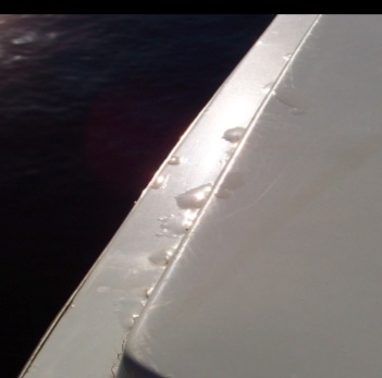

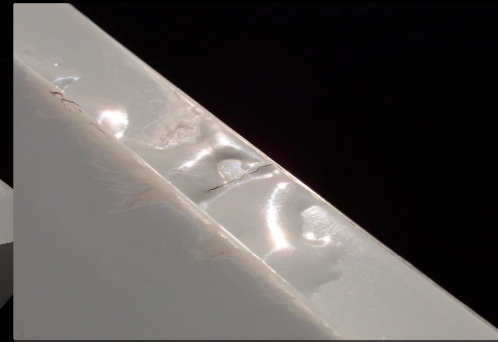

    I am re-caulking the rub rail this winter and I noticed the paint on rail is in bad shape. Anybody know what type of paint to use on it?

    SEMCO has a good line of very durable products for painting high wear type areas.

    I called Jamestown Distributors and they said any topside paint would work , but as suspected with any paint job they said sanding would make or break it. The top side of a rub rail is hard to sand without scratching other surfaces so they also suggested a primer first to fill in some of the craking etc...

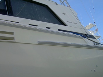

  7. Ormond Bert54
    Ormond Bert54 Senior Member
    Mar 29, 2009
    470
    Ormond Beach, FL
