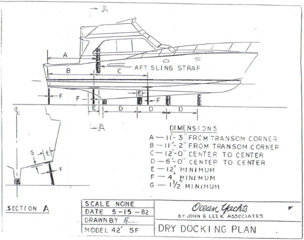

    Hi Michael we used to own a 1989 38 ft ocean and from wat i saw the hull was solid fiberglass below the waterline, and the core above. I also experienced keel damage from improper blocking. From what I recall reading in the vessel manual, as was common in oceans of that era, the keel is non-structural and is only for directional stability. So with regards to blocking its crucial to put more blocks on the chine and not to rely heavily on the keel. I have also found the blocking instructions that was sent to me from someone at ocean back when I had the 38.
