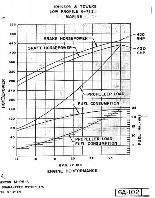

    I attached a fuel graph for 671 TIs
    I understand if your engines are running correctly and you can get max load WOT your fuel burn is going to be really close if not exact.
    I have 671 TIBs and I follow this graph pretty closely.
    I don't have floscans.
    I always round up to 2 gallons per nautical mile at cruse when planning a trip.
    I burn less fuel, but I round up for math and safety margin.
    At the end of the trip I always seem to have left over fuel and
    fuel burn seems on or close to the below fuel burn graph.

    I have an 84 43, with the same engines. You will burn in the low 30's per hour at 2000-2100, matching the graph above. You can run 10-12 hour days, with your fuel tankage. A 200 mile day is probably a safe maximum. Keep your plans very tentative and flexible. Weather, this late in the year, is tougher and may force you inside if you have to keep moving. Congrats and best of luck with the trip!!

    The above graph seems a lil conservative to my reasoning. However, the graph and I do agree, He should be consuming a lil more fuel at 2100RPM .
