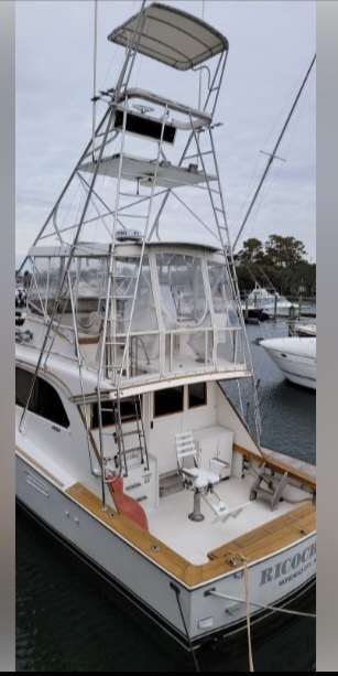

    Doing a survey on a 1981 Post 42 on Tuesday. I'm really excited about this boat. It has the 671 Ti 450hp and full tower. The best thing is I think the wife is way more stoked about it. If things go as planned we will close on the 12th and have it in its new slip before the end of the month. Stand by for questions

    Unfortunately the old girl showed her age during the survey and we had to pass. We are looking at another 42 a year newer.

    You may find that they all have similar issues. Fuel tanks are a weak point. Wet/compromised foredeck core, wing panels, trailing edge of the FB deck. No holding tank is another typical finding.
