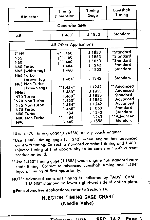

    mysue Guest
    injector timing
    My DD manual and I are seperated by 300 miles for the holidays. Does anyone know how many mm the setting is for timing an N70 injector on a 12v71?
    Thanks

  17. K1W1
    7,392
    If you are completely stuck get a pair of verniers and measure the heights of the Injectors prior to pulling them out.
    A Timing Tool is not that hard to improvise as long as you know what height they should be.
    I once lost the tool on the way to a job and made a 1.484" tool out of a 2.5" bolt and two nuts. It took a couple of goes to get the nuts tight at what I measured to be correct.
    The engine fired up and ran fine all the way from Papeete to Panama with no Injector or other problems other than a few failed drive belts for a layshaft that drove too much for the belt size.
    I found the tool when I got back to NZ sitting on the floor of my car where it must have fallen when I was getting the rest of the stuff ready to go. I still have it although it has not been used by me since.

  19. mysue
    mysue Guest
    Not stuck at all, just time to run the verhead and adjust the injectors. I've always used a digital vernier to do this on other engines and gotten very good results. Was just curious as to what the hieght was on a 12v71ti. It's in my book, but I'm currently away from the boat. Again just curious as to what height was. Thanks, Gary
  20. Capt Ralph
    12,725
    There are some variables. 70s should be naturals. Advanced cam is your concern. I run my own racks and have the manuals with specs. But if you have never set your own racks, get someone who has, especially on a V. If your guessing, it's dangerous even with the tool.
