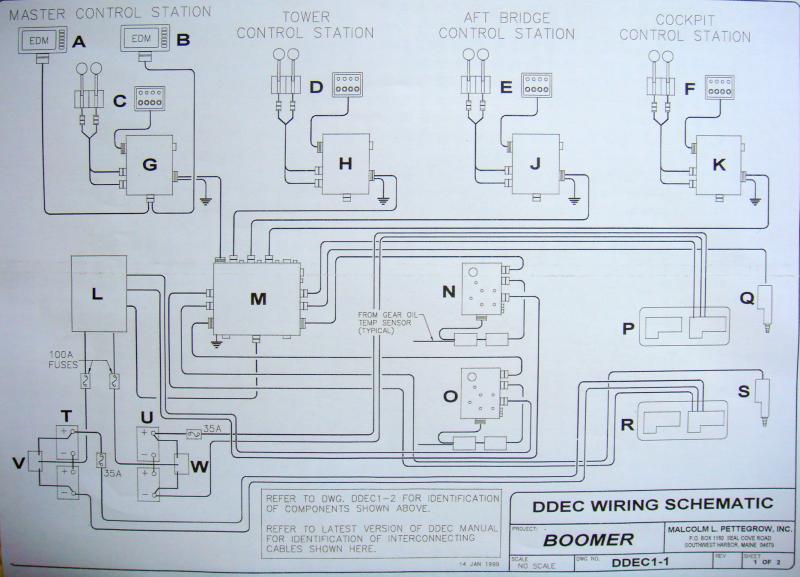

    Pulling my hair out.. Have been reading all the related posts on the 92 series and DDEC.. I have checked all my manuals etc. replaced my house 12v battery's and isolated all my stations... OK, engine start up and leaving the dock great.. Both engines running fine, everything working... Get out tothe entrance channel and go to throttle up... Loose my port engine.... Will not restart....
    Have to idle on stdb out to deep water ... No throttle on my stdb engine.. Try to re-start the port.. Wants to drag the stdb down... Not good...
    I manage to milk the throttle up to maneuvering speed on the stdb engine and return to the dock...
    OK, go thru all the systems checks etc. Read all the forums on 92's and DDEC systems...
    Change batts, Isolate stations. NOW.... I have no Throttle on my starbord engine in gear.. JUST OPPOSITE..!!!!
    WTF..???
    ANY suggestions, comments..?? We are currently in Punta Cana, Dominican Republic and have no real access to a DDEC mech here...
    And please.. I am keeping these engines and need no discussion on the merits of the 12V92's or DDEC.. This is what I have to work with.. thx....

    Also, don't have , or have not found the quick manual for the menu combination to re-set the DDEC controls to default...
    Anyone know the button push combo to reset the system..???

    What about the emergency backup controls? Do they operate? If trying to start the port engine causes the stbd engine to stall, then it sounds like the engine batteries are weak. I've come across this problem before many years ago, but cannot remember what the cause of the problem was.

    Yes.. same serrano... Just replaced 2 of the 12 volt batts in Feb, and they other 2 a couple of days ago.... I have good voltage.... 13.00 at rest.

    did you check the simple stuff first?
    since you just changed the batteries.
    check that the battery cables are on tight?
    maybe check battery under load, i have bought bad new batteries, or if the ground is bad or loose you will show good voltage under no load but put a load on it and you will have a voltage drop.
    Do the DDEC need proper voltage to run? i suppose so, thats why there is nothing like the older DDs that dont need any electricity to run.
    After that i guess you will be flying in someone from DDAC in Miami or PR.
    good luck

    Sounds like a voltage issue to me. I would rev them up at the dock and check voltage. Also check the primary supply voltage to the ERIM. Black box mounted on the bulkhead maybe. Big black and red cables on the bottom.
    A bad ground or loose ground connection will throw the system into a fit. If back up control system does not work properly I would definatley look that direction.

    check your emergency stops:confused:

    I had this same problem with them many years ago......If I remember there is a fuse in the ECM or somewhere around there, possibly inline that went bad.

    I am looking into the voltage problem... I would like to know how to do a reset of the DDEC system... using the program buttons on the bridge displays...
    Checking grounds and fuses today...

    Have checked the fuses and grounds.. all good.. I do have a problem w/ my La Marche constavolt cooking my batteries... Won't come off 75 volts charge... New batts last feb and water gone when I got onboard last week and no one was onboard... Now that's bad.... The constavolt could have not run very much..
    Recommending a change to a new smart charger to my Boss.. any recommendations?? I am leaning toward a Charles 60 amp 5000 series...
    Also have equalizers inline w/ the 24 volt and DDEC system... Lots of fuses to check....

    Your issues are voltage related. Start from the batteries and work your way thru the main battery system. Do not overlook or assume anything. Most boat builders installed these engines with common grounds but seperate battery banks. This is fine but these engines need 2 power sources to run. One for the starter and one for the ECM. While you are cranking/starting the engine the ecm feels the drop in voltage and if it is below 10 volts it will not start. I move the power supply to each ECM to the oposite engine to prevent this voltage drop. If you supply the ECM for the starboard engine with power from the port then it will never see the drop in voltage during cranking and vise versa.

    From what I read, your changing and moving batteries around. Your problems keep getting bigger. New batteries don't mean good batteries. Load test every one disconnected from the banks. Your new fried batteries may have caused the charger to fail, or the other way. Are your banks in parallel or series? You sure?
    You may have bad strapping somewhere. Get back to basics, follow every cable down both ways and make sure it is a ground, hot lead, drain, bonding, hot cranking, parallel or charger lead and properly connected to the correct post.
    Don't be in a hurry to reset the DDEC controllers. If you don't know how to reset them, then you may not know how to set them back up if needed.
    I do like the idea MDS has above. Get your stuff working first, then get an electrician on board that can safely and correctly make those changes. AND, update your schematics with those changes.

    It s all coming down to voltage.
    You mention changing the house battery which is really irrelevant.
    How many engine batteries do you have, how are they connected
    Have you tried paralleling the engine banks? It s not a permanent solution but should boost voltage. If everything runs fine paralleled then you know it's a voltage issue
    Have you checked that the alternators are charging? Often they need to be rev'd over 1000 to kick in
    Was the charger on when you had the problem?
    I really don't think that swapping the ECU feed is a good solution, if you have a problem on one engine you ll take the other one out. I want each engine to be isolated from the other.

    MDS has a good point.. I will follow that.. My 12 volt 8D's are in series to make the 24 volts... And the constavolt did certainly fry the batteries... Won't step down off the 75 volts.. Wish I could post a picture but mine are to large for this site.. I may be able to post a pic of my DDEC schematic... I just came on board a week ago.. Finding the system screwed and tracing it down to the charger and dry batteries.... Saved one by re-filling w/ distilled water, but the other won't go past 4.5 volts.... These were both replaced in 2/11...
    Here in DR, there is no one or any facilities to do this kind of trouble shooting or repairs or for that matter smartcharger / constavolt changeouts...
    I hope to replace my bad battery w/ a new one, have the owner bring down a portable 24 volt charger that I can use when needed (not running and underway) to keep the system up till we get to St. Thomas or St. Croix where I can get some better help, supplies, equipment...

    If you consta volt is putting out more than about 37 volts the ERIM will shut down due to high voltage.
    Ecm's don't care for high voltage to much either.
