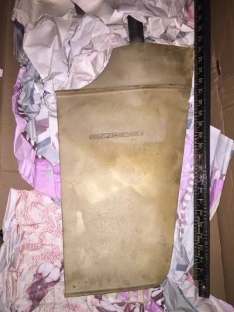

    Also, apparently there was a re-engineering of the rudders at some point which apparently significantly counters the following sea handling.
    I have a pair of these new rudders in the shipping crate, some day I may get around to installing them.

    (RT46, could you give more info on the new rudders??)
  7. RT46
    RT46 Senior Member
    Feb 22, 2011
    1,058
    I went out to the shop and opened the box.
  8. P46-Curaçao
    P46-Curaçao Senior Member
    Mar 8, 2013
    734
    Woww, that's a complete different design... I'm vey interested how it handles if you have mounted them!!

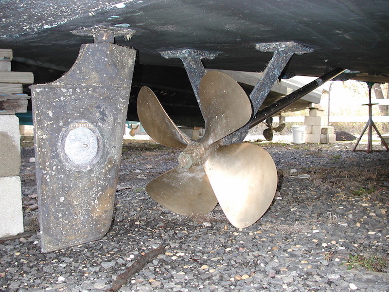

    I put those rudders on my 42 after losing one rudder due to corrosion. I also replaced the rudder ports and replaced the wood crossmember with a built up fiberglass board.
    http://s96.photobucket.com/user/porthole2/library/Boats/42 Post/Steer shelf rudder?sort=9&page=1
    Big improvement in handing over the originals.
    I also found using a fast acting autopilot really helped in a following sea. Although there were times I just had to change my course when coming to keep the ride comfortable.

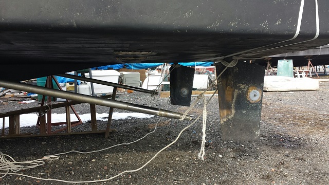

    This is what is on mine from the factory in 84. Bigger than even this new design. Could be why I don't find following sea handling nearly as bad as some claim. (Pic is new cutlass bearings this past winter)
  18. P46-Curaçao
    Mar 8, 2013
    734
    Woww, that's a huge difference with mine, any idea where to buy?
