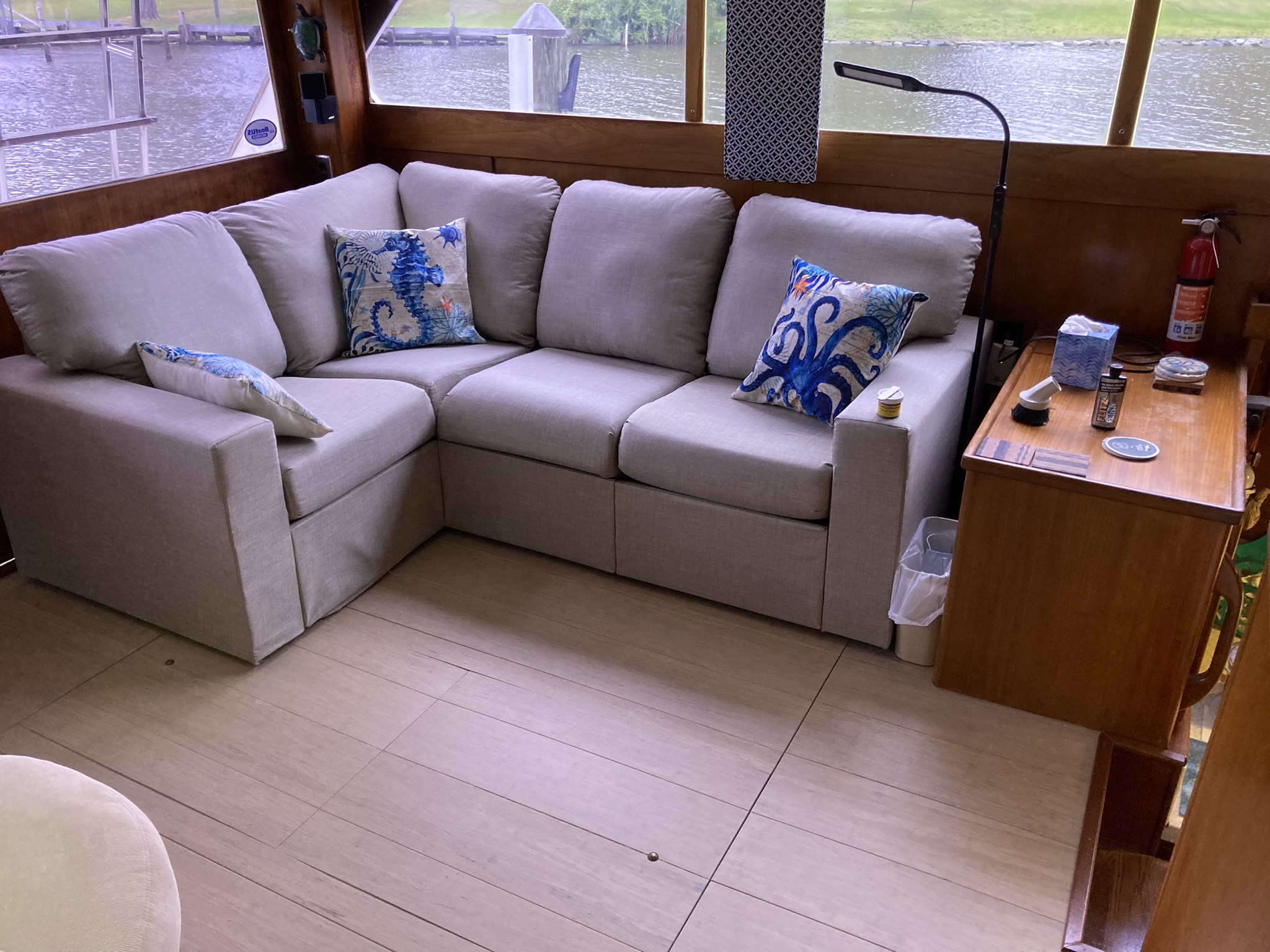

    I put in a bamboo faced, synthetic core, engineered floor but I don't like it. It's heavy, dodn't like they way it cut/planed or installed. The core is terribly temperature unstable. I was on the boat yesterday, it was about 10 degrees cooler than when I installed, and the hatches had enough bow in them I could see the seams curve and hear the floor 'click' as you walk on it. I thought water was the only thing tha expands when it gets cooler. I won't be surprised if this uninstalls itself during the winter when it gets down to freezing.
    I found a bamboo face, eucaliptus core floor. It is ligher than the synthetic core but is 9/16" thick which is thicker than I can use so the main hatch hinges will still open. If I can find a place that will mill the back face on pre-finished flooring I'll probably purchase that material and try again.

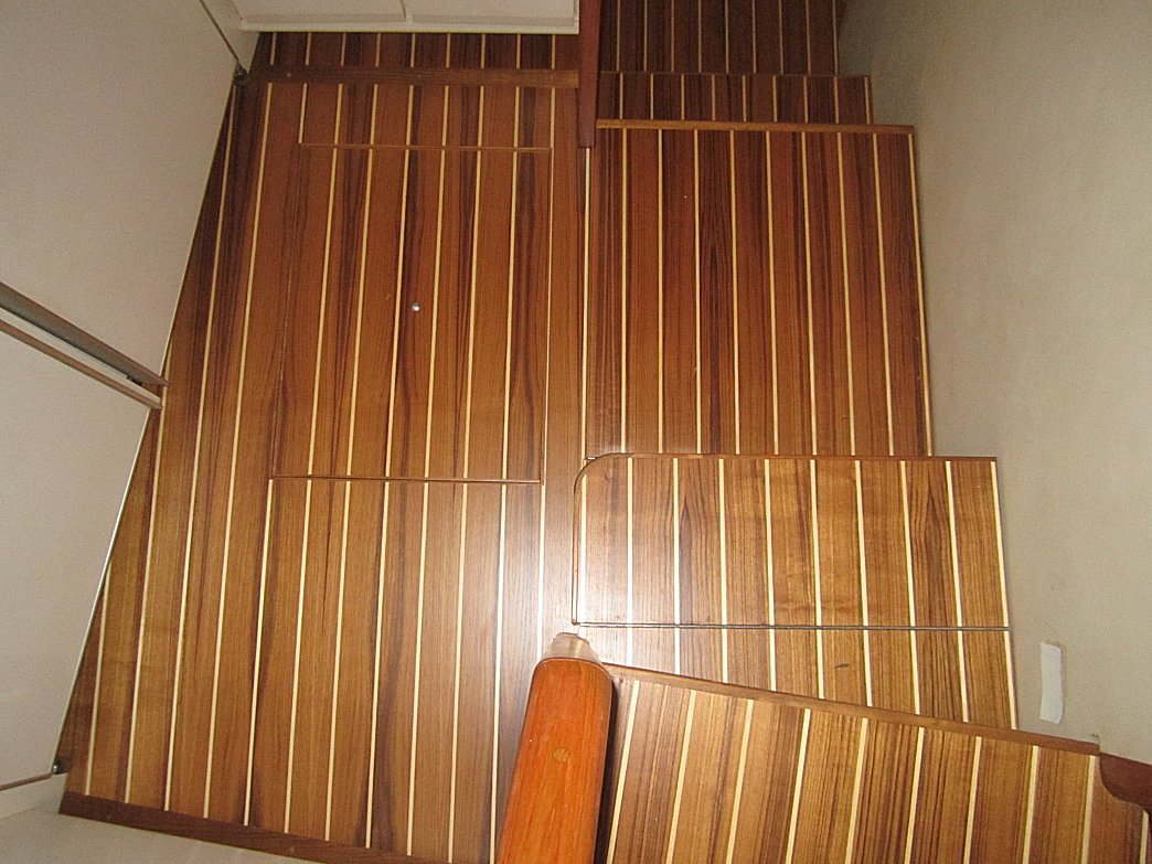

    Replaced ALL of the carpet with Teak & Holly glued down and cut for easy removal of existing hatches. Img_0526.jpg
