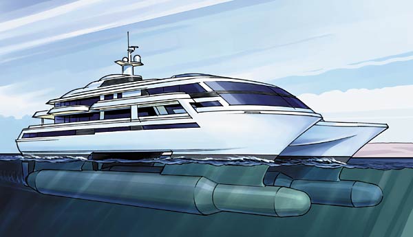

    Abeking & Rasmussen in Bremen, Germany, is building Swath ships. They have some information on their website, unfortunately a Flash-site so you have to find it yourself under the headline Ships and also under Yachts where I found the illustration below; http://www.abeking.com/flash.html
    Look at the movie where they compare Swath to a monohull, unbelievable! Who will be the first to build a big Swath-yacht?

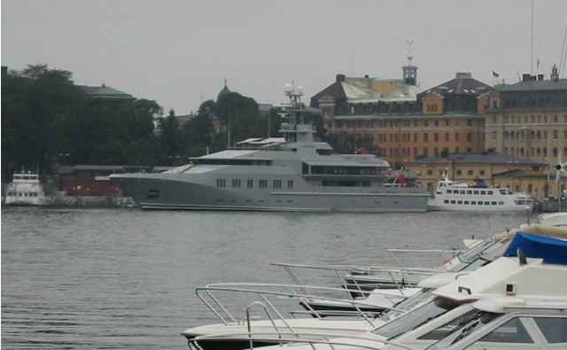

  15. AMG
    5,375
    If there is any significant effect it is probably to the contrary. The high "chineline" is more of a design gimmick that Espen came up with almost ten years ago on a fast yacht concept which I believe was never produced. Then we have seen it on Skat, where I think it works very well and on Princess Mariana where I think the combination with the sloping nose looks a little strange...
    Here she is in Monaco; http://community.webshots.com/photo/145151065/145151065uOPkbO
    and here is Skat when in Stockholm;

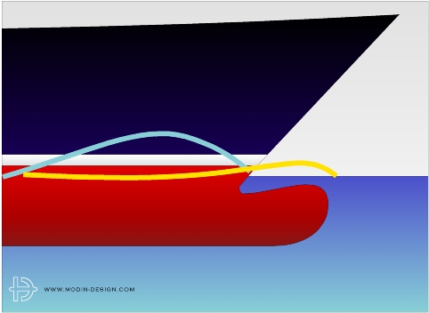

  17. AMG
    5,375
    You are right in that the fine entry makes less resistance and also increase the pitching, which the chine should stop. But the higher up it is, the more pitching which is also slowing the boat down.
    With a bulbous bow this problem is much reduced and this is the similarity with SWATH ships. As seen on this drawing the bow wave is built up before hitting the bow (yellow line) and is by then already moving down and to the sides. Without the bulb (blue line) the bow vawe is growing up along the foreship and makes more resistance.
      48.9 KB
      6,369

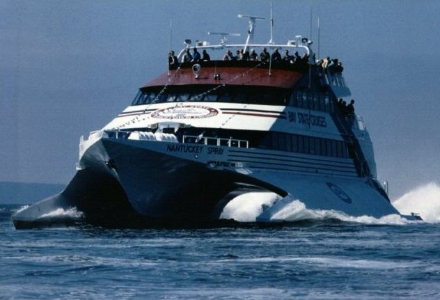

  19. YachtForums
    20,375
    Came across a commercial ferry with SWATH architecture. Note a deep-v bow section to diffuse waves passing under the hull.
