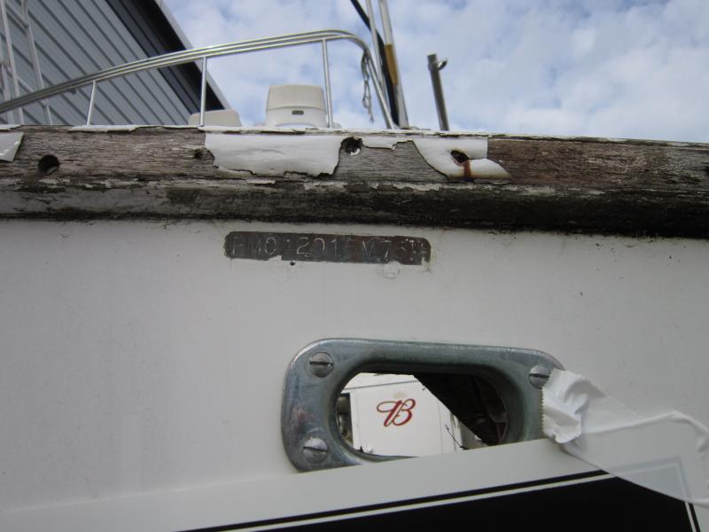

  9. cptnpete
    cptnpete New Member
    Jan 23, 2012
    26
    Scituate MA
    Hi, Maybe I am unclear on Post Hull numbers, but I always thought my 1975 42 was hull 15 as shown in pic attached.
  10. baltimore bob
    baltimore bob Member
    Sep 22, 2013
    314
    Baltimore, Maryland
    I see PM042016M76 I would take that to mean Post Marine, 042 feet, 016 hull, 1976 model year. Mine does not have the in hull marking, however in Egg Harbor tradition, Post marks components for the hull they are to go in, at least they did back in our day. If you pull the center engine hatches the aft inside of the starboard longitudinal (removable) hatch support will have numbers stamped in it. The last number or numbers is, I believe the hull number. If it isn't, I've lied to many people about mine being 42 #3!;) ;
  11. cptnpete
    cptnpete New Member
    Jan 23, 2012
    26
    Scituate MA
    Thanks, if you are able to zoom in you would see the 6's are actually 5's. Hull 15 built in '75. Which is also what shows on documentation/title documents. My boat also has an original Post plaque with Hull 15 on the mahogany overhead above steps down to galley.
    I haven't noticed any other hull ID in the hatch location described (but I do have another boat that has her official stamped hull number but she got a few components marked similar to what you have described for another hull number - the factory was careless I guess - so I trust what is stamped on the hull).
    Mine is a glass hull, glass over wood decks and house, glass bridge and was an abandoned boat needing work when I got her. Gas engines (newer 502 BBC). She is going to a new owner soon who will give her the love she needs.
    What I don't get is how a newer boat built in '78 would have a lower hull number.
  12. mwwhit1
    mwwhit1 Senior Member
    Jan 19, 2006
    239
    Jersey City NJ\Boca Raton FL
    You guys are right with your thinking. They start with PMC which is Post Marine Corporation. The '78 is probably hull 111. That is the 4th model year of the 42 so it can't be 11.

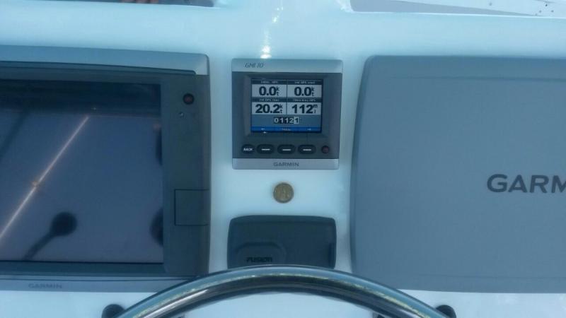

  14. Capt J
    14,432
    I would say that 17 knots is good with naturals.
  15. Gambetica
    Gambetica Member
    Aug 3, 2013
    45
    Venezuela
    Cool! We are happy with the 17-18 the boat is making, And my friends of the marina lost the wagger!!! She did more of the 14 they expected!
