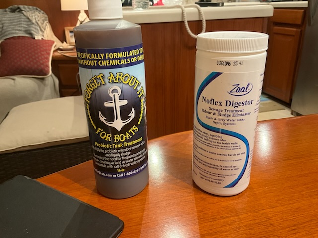

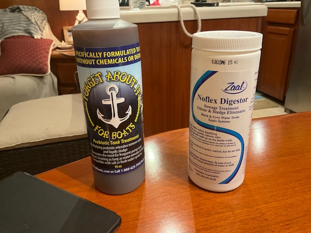

    I find both of these products to work. Once you start using it don’t use harsh cleaners in or on your toilet as it will kill the enzymes (?) that “eat” the sewer. If you find the odor is in the bilge pour some of the forget about it for boats in the nasty water and give it some time. You could use the Noflex that way as well. This is not a permanent solution to your problem but will hopefully make dealing with it a little less unpleasant.
