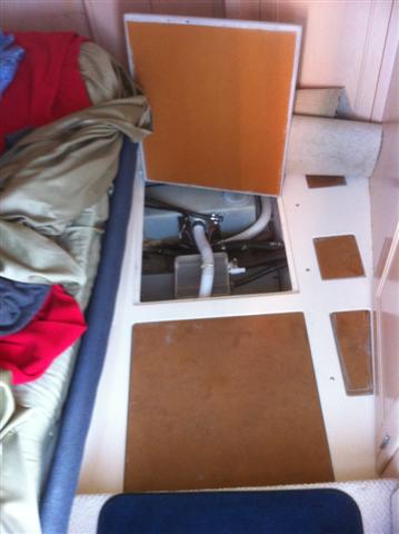

    On my 1999 Carver 404 the aft shower sump is located under the floor just aft of the blackwater holding tank. Yours should be in the same location.

    You are absolutely right. My mechanic (a different one) knew where it was, and it was right there under the carpet. Not the most intuitive place, but now that I know where it is, it's fine. At any rate, my mech fixed the problem and it is solved. As for the water in the small bilge area under the galley deck just outside of the fwd head, I believe that that water is also a result of overflow from the fwd shower sump, and I am going to have that serviced as well.
