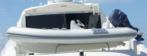

    Here is a nice way to do it. Basically the same thing Ken was talking about. This one if for a tender but it is the same idea. You can also make them removable so that you can use the space for something else if the jet ski is off. I'll go through my pictures and see if I can find anything else that would work aswell.
