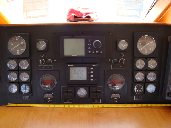

    VDO Guages (and others) in hardcoat anodized aluminum panels

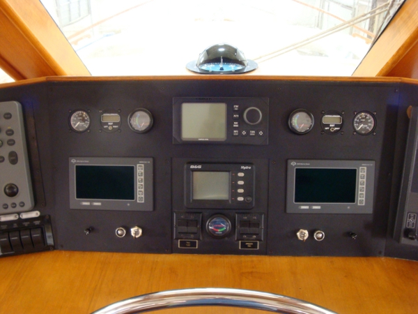

    MMDS displays and some extra guages after repower

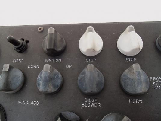

    I have located all the gauges thanks to all the helpful replies. Now I need to see if I can find some switches that match the ones on the existing panel. Does anyone have any ideas on the manufacturer of these vintage 1997 switches?
  13. Capt J
    14,434
    Lauderdale Speedometer or Ward's Marine Electric in Fort Lauderdale should have those switches......I bought them at one of the two places a few years back for a boat......I forgot all of the info of them though......
