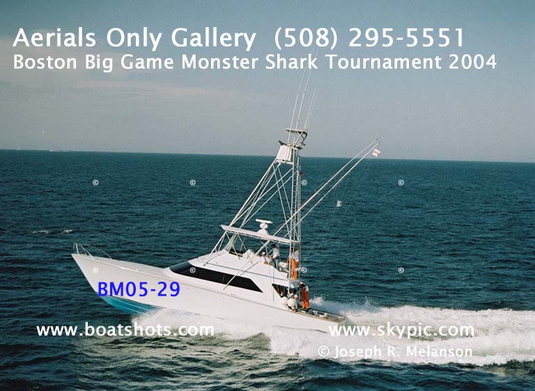

  6. Capt J
    14,435
    Come on now, that tower is nothing compared to the one on "cookie too". This one will really make that pendullum swing.

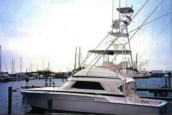

  8. Capt J
    14,435
    A 46' Bertram with a tuna tower rolled over inside of Hillsboro Inlet many years back while it was sitting in relatively calm water (no more than 1 or 2 foot rollers). The cause was determined to be the 7 or so people standing in the top of the tuna tower which upsetted the stability too much.
