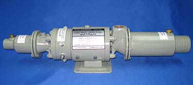

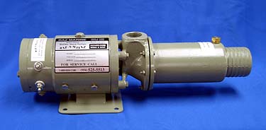

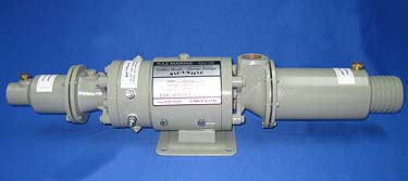

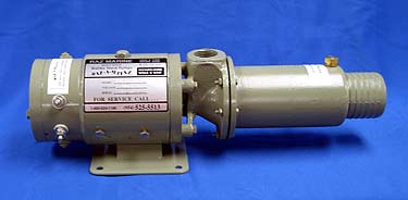

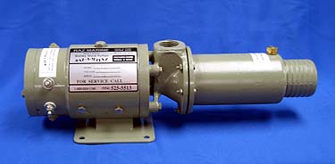

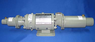

    I assume it is one of these?
    And do you hear the pump running? They are very loud.

    I push/hold the flush button and the bowl fills with intake water, but it seems the outgoing (sucking contents out of the bowl) can't keep up with the intake pump. That being said, I did close my intake seacock and pushed/held the flush button again and if I hold it in the bowl will empty. (5-10 sec) So is my problem at the Macerator side of the bullit pump? BTW, I have the bottom pump in your photos.
