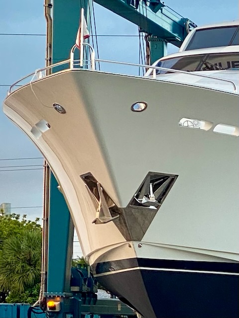

    many worst anchoring experiences came after I took over the lazzara 110 I m running now. It had two 200lbs Poole type anchors which simply wouldn’t hold the boat even in everyday conditions without at least 10:1 scope. First trip to the exumas was a nightmare. I eventually found a 400 pounder which solved the problem. Drop and done. No worries. It looks a little funny on the bow but I don’t care :). It sticks out of the pocket and we had to add a couple of SS blocks for the flukes to snug against but again I value my sleep…

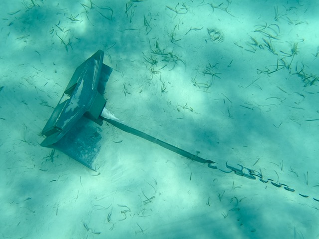

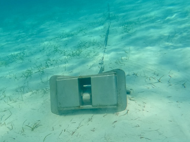

    For a chance to snorkel the anchor today, at Big Majors Exuma and took come pictures. It s been pretty good so far since we installed it last year but I still miss a Bruce/Claw. I have to use 50% more chain than I used to.
    With the 84 Getting the 176 Bruce out of the bottom in this very same spot felt like pulling a teeth… I would often just wait a couple of minutes with the chain right above the anchor for it to pull out of the bottom. This 400 pounder comes right up without putting a fight.

    Sorry if this comes across as an attempt to teach grandma how to suck eggs, but it seems to me that you should give that anchor a bit stronger reverse pull, after dropping it.
    In fact, I don't see any sign of drag in front of the anchor, and it looks very lightly buried in the seabed.
    I guess your previous Bruce was faster and very good to set into a sandy bottom - though I wouldn't trust it a lot in a weed seabed.

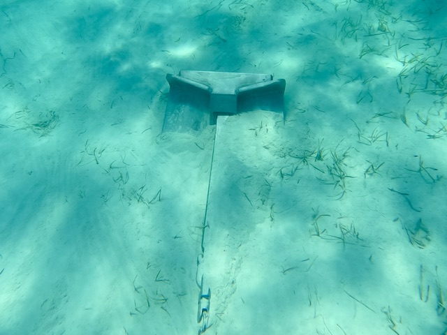

    But when I had a boat with Hall anchors, which arguably are even more rudimental than Pool (and just about anything else!), here's how one of them used to look after a decent reverse pull on a compact sandy bottom...
    ...and the winch did struggle a bit to recover it!

    I ve never had to do this with the Bruce, the weight of the boat and windage, 84’ with 176 lbs anchor, once the chain was out the boat would just snap into the wind.
    that said, the windage should pull enough to set it deeper. I don’t think it would set any deeper using power Couple of days Ago the wind picked up to 20/25 and we dragged about 50’. No big deal but that never happened with the Bruce. Extra wind should be the same as using power to set.

    Pascal, on that BA Poole;
    Could some adjustments (with a big grinder?) be made to increase the fluke angle?
    Maybe some grinding to help the flukes poke into the sand a lil better also?
    I'm wondering if a BA Claw anchor would look better in that hawse anyway.
