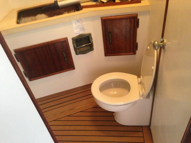

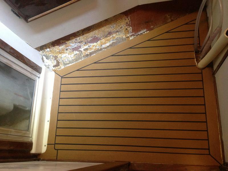

    Old crown head gave up so ripped it out along with all the plumbing and flooring.Installed plasteak flooring, next up marine elegance head,electrascan,
    granite counter top and vessel sink. Only get to work on it every other weekend so will post pictures as it progresses...

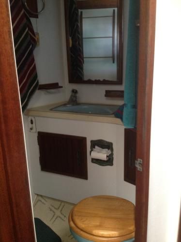

    Before picture
