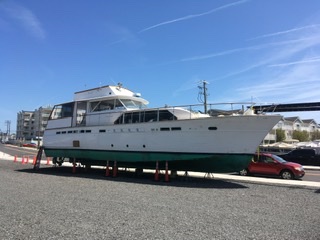

    Unfortunately this once beautiful Chris-Craft Connie is getting chopped up at my yard here in South Jersey, Wildwood NJ tomorrow.
    was taking on water off Cape May /Wildwood NJ .
    captain beached it on the rocks at Hereford Inlet.
    I’ve already claimed the “Badges” hands off !!
    DD 8v71s in running condition… salvage company wants to sell those.

    Lots of openings on the boat below the waterline where the transom meets the hull.
    Garboard planks are leaking water from with in and the small chine planks up forward are missing.
    oh boy..

    Alpine green Detroit’s look good.
    Seems to be well-maintained no rust etc. really visible. Look to be in very good shape.
    Think I know this boat I believe it was on one of the upper Chesapeake Bay freshwater rivers for quite a while.
    No barnacles on the bottom.
    Worth a look if someone out there is looking for a pair of 8V 71Ns.

    Blow up the picture. Last 10' of her stern is sagging. Shame for this ole gal.
    Two chain saws, forklift and two large chimerical dumpsters. Gone in two days.

    pretty much every 57 constellation I’ve seen has that drop in the back haven’t seen a straight waterline on one of those boats in a long time.

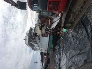

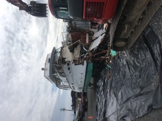

    2EB5E3E7-D858-46DF-9075-8CE8339A4614.jpeg Pascal , you are correct Sir…
    Boat heading south , came upon Hereford inlet and thought it was Cape May.
    Planks went to popping and he grounded it just before the bridge.
    they are GM diesels btw. Pre-DD diesels.
    The good ones!
  8. cleanslate
    cleanslate Senior Member
    May 29, 2018
    1,661
    Cherry Hill, NJ

    Forget what I said about the motors these guys were hacks and destroyed them pulling them out.
    Relatively new looking north pro generator might be worthwhile.
    they cracked both cast-iron coolant tanks on the front of the engines screwed up the exhaust riser and the air filter boxes on top of the engines are all out of whack now…
    I Sure was eyeing up the rectangle
    Sen-dure heat exchangers in the tanks , now exposed…they would fit my engines …..
    Oh well.
