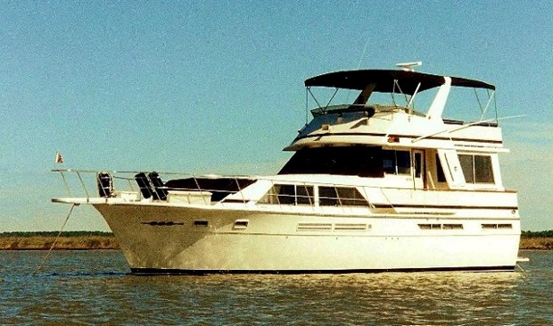

    Constellation 500 Fuel Burn Rates
    The Constellation 500s and 501s have Detroit Diesel 6V92s (both TIs and TAs).
    At 2000 rpm they burn about 38 gph and you get about 18.3 knots. Their fuel burn is about the same as any other 54,000 lb. diesel powered motoryacht. They are neither frugal nor thirsty.
    But since 2006 most owners are running at about 1400 rpm and getting about 10.5 knots. In this semi-trawler mode they burn about 14 gph (for the pair) which gives them a fuel mileage of about 0.75 NM/gal.
    The picture below shows my Connie 500 at rest on a quiet October evening.
    CaptOlin
