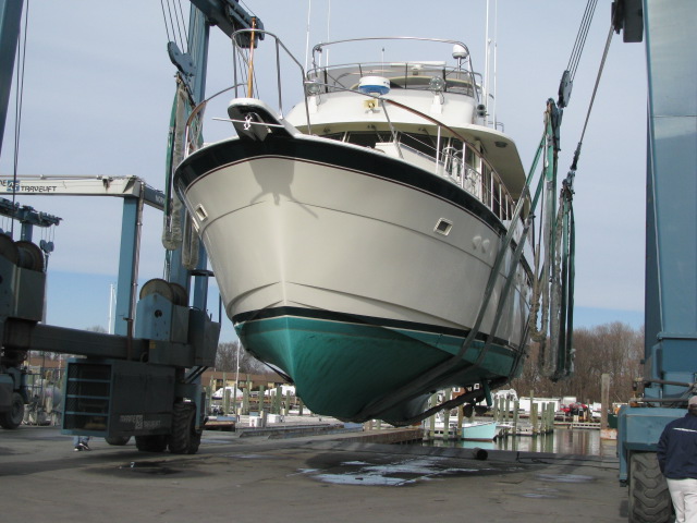

    There you go. Foolish me was looking for the symbol on top and missed the "Upload a File" below. Now for the OP, does removing that keel look like a job you'd like to get involved with? IMG_3407.JPG
