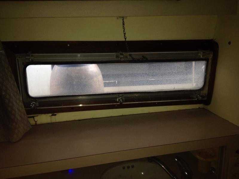

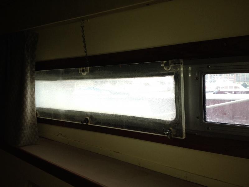

    One thing that has me puzzled is the aft cabin windows. I do not know if any of them were designed to open. This vessel has a very thick plexiglass that is on some type of hinge. It does not look like something that would come stock from the factory. There are one on each port and STBD, as one in the aft head.
    Are these normal, and where can I get the proper hardware to put it back to the original !

  20. Capt Ralph
    12,649
    yep, those are Bertram windows. Should have wing nuts on the bottom studs. Loosen the wing nuts, drop the bolts down and lift in & up. When open, a hanging chain with a T bar fits in the slot the bottom bolt was in to hold it open.
    Now the bad news; They are leakers. Usually they are sealed shut. Any parts and hardware is up to you to make and find at your fav hardware store.
    I had to make new studs from threaded stainless rod, square the end, fit a cold pin hinge. You also want thick & wide flat washers under the big wing nuts to save the plexi window.
    The frames are made from aluminum. Taking them off of the hull in one piece is not going to happen. There are no (new) replacements.
    I had to experiment with different gasket material. Found a nice grey D gasket with an adhesive back from somewhere.
    There is no channel to hold the gasket in place, it will usually start to fall off after a few uses.
    A few years ago, used up the last of that gasket stuff, bolted them down, have not opened them since and wont.
