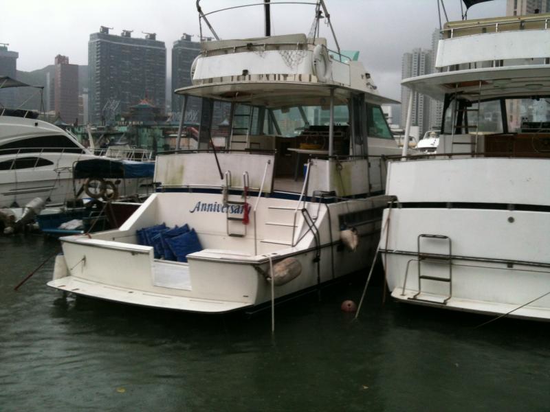

  7. Hkalan
    Hkalan Member
    Sep 3, 2013
    43
    Hong Kong
    Hello,
    I will check the bilges tomorrow. The owner has given me the "thumbs up" to keep searching for the HIN !
    It has been sitting for a year, and the neighbouring vessel owner (another Bertram) starts the engines ones a week.
    Although she has not been properly bathed for a long time, you can see in the picture below how they extended the hull. The boat next to it is identical but without the hull extension.
    She just needs the TLC she deserves !
    Alan

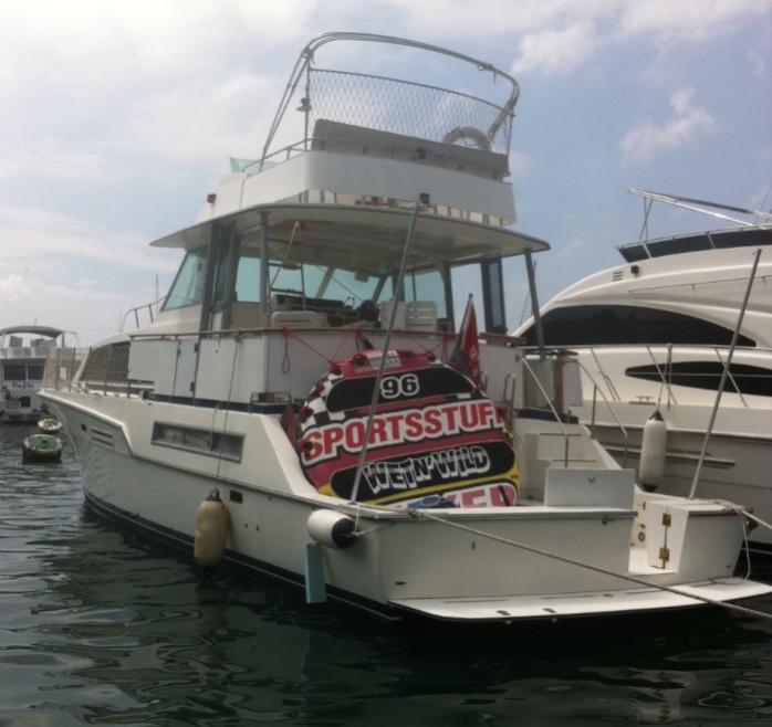

  8. Hkalan
    Hkalan Member
    Sep 3, 2013
    43
    Hong Kong
    Hello,
    Here is a picture the owner sent me tonight. It is a year ago. It shows a better angle of the extended hull, and why I can't find the HIN on the transom.
    Alan
  9. Capt Ralph
    12,647
    The top step down to the cockpit is covering the hin. Does that step open?
    Were on a 58' and our number is stb / transom, 1 inch under the gunnel 8 inches from the stb hull side.
    Your rub rail comes low and I wonder if that is still the mold cap. look under those steps just below where your old transom rub rail used to be.
    I have never found any other hin location on our 58.
