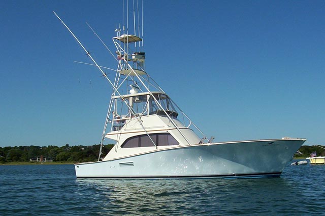

    Hi All,
    Looking for help / ideas on how to replace / fix two cracked side vents. I picked up this 79 Post in October of 2014 and during a haul out prior to purchase the previous Marina cracked the two vents (see picture). Despite some searching by the old owner, myself and the old marina we have not been able to source replacement parts. (The oldMarina is going to cover the cost and install once we figure out what that actuall is..)
    According to a contact at Post - "I’m sorry to tell you that those parts were custom made by Post in the late 70’s and early 80’s and we no longer have the mold to make those."
    The parts are plastic
    Advice to date has been the following
    1. Remove and somehow reverse egnineer with light metal
    2. Leave in place, use fiberglass to repair.
    3. Remove and fabricate out of fiberglass.
    Any help with locating the parts, advice on the fix would be great!

    Hi: I am in Old Saybrook Ct with a 77. I replace mine with custom ones like 80s type. When I removed my old ones I found there is a set of the same facing in the engine room. You could swap them out and put the cracked one on the inside you do not see it. Just a thought.

    Sometimes you just have to go with plan B. Find another type that fits and 5200 them on. Otherwise you're left with 2 or 3 above. Beyond that keep your eyes on Post forums, and especially look for Posts being scrapped. I suspect that anyone with spares is holding onto them because they do get broken. We just replaced the 2nd one in 2 years on our Hatt. Needless to say we got a spare.
    P.S. that doesn't look like a hard shape to duplicate if you have a decent fiberglass guy.

    Hi Tom: I gave those to a friend of mine that had broken ones as well, and he used them. If I remenber they were through bolted the nuts were not easy to get too. I had the hull painted and took out the vents totaly. I made new ones like the 80s and cut them in. They came out nice, I have people fooled with the year. I will see if I can take a pic tonight.

    I am not positive on how the bolts are secured from the inside. From the outside I can clearly see 6 flat head screw tops. I peaked around in the engine room, but I think a portion if not all of the vent actually sits above the floor in the salon. Espcially for the vent which is in the center. I am thinking this means the pannel inside the salon would have to come out to access the nuts... if they in fact exist.

    If the old ones can be repaired with resin and cloth that might be your best bet
    Otherwise try a mold made of modeling clay. Push an undamaged vent into the clay with a releasing agent. Then use the mold to reverse build from the gel coat to the cloth. Or just use resin and cloth the whole way.
    Another is to take it to a body shop and they will duplicate it for you
