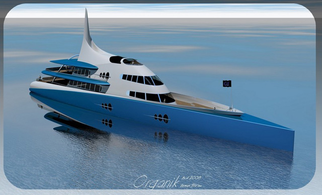

Exercise de style
Length : 80.00m
Speed : 20+ kts
Propulsion : hybrid + fuel cells
Just an idée.......

A pretty interesting design, but what is that thing sticking up like a feather?

The fin on the top is dedicated to a purpose everybody seems to have forgotten when installing fuel cells and other hydrogen devices : safety !
A continuous ventilation of technical rooms where fuel cells and/or H2 cylinders are stored is required, and the exhaust should be as far as possible from accomodation areas. Here is the shape, inspired from killer whale back fin.
A second purpose is to shelter all antennas and radomes, if the fin is made of specific composite material as used for naval grey ships I'm familiar with. That's why you see no Satcom nor navigation radar antenna. Everything is integrated and we can keep this smooth design for top part of superstructure.

A baby Sigma!!! I do kinda like the big, bold windows for the helm. And the style of the triple portholes on the hull. One set only though, two is overkill.

I need my portholes for guest cabins : 4 in lower deck, with portholes for everybody. Maybe I will reduce the size, to look "lighter" on ship side.
Anyhow, they moved slightly aft after consolidation of the GA, to cope with tender hatch located forward, with the tender I started to sketch also.
