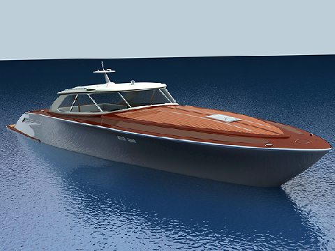

    last year my works..look forward any comment. thanks
  2. dccd
    dccd New Member
    Jun 5, 2007
    10
    US Gulf Coast
    Pilaster
    Nice render and I like it as a west coast type of design, IMHO I would only work a little more on the Pilasters. If the half rounds they sit on were eliminated and that corner returned to the lower cabin, it would make the pilasters seem shorter and I think a sleeker profile. I also would not leave those corner radius bends in the aft glass, too much for an otherwise classic feeling boat.
    Overall a stunning rendering

    I can only comment from a practicality perspective and I think the aft cockpit is too small.

    Hi dccd
    thank your comment.
    Do you mean that if the places of the galss wall curve too much would make the wall too short?
    I just find out that if the curve is too much , we will lose some usefull space..

    hi nilo
    yes,,i also think the aft cockpit is too small as your standpoint .Maybe make the cockpit space bigger will be better..But i have taken a longtime to change the plan drawings...However i also think the fore head of lower deck may be too small.
    I am attaching the plan rendering for discussion ... What do you think about the plan..Maybe just a little change the aft cockpit to biger will be better ?

  9. dccd
    dccd New Member
    Jun 5, 2007
    10
    US Gulf Coast
    Pilaster
    TZ, since we don't speak the same language we can better communicate visually. I took the liberty of drawing my comments.

    OH yeah, I understand now, thank you for you maked the mark for comment...
    i am a chinese designer ,,and my english is poor..so very difficulty to learn comments for me..but i can see the idea from the drawings..so design language only one type for all people..
    as for your idea is very correct..before
    i also dont liked the profile of Pilasters and feel here have problem..but the boss cant give me more comment for this.so just pass..
    if need change i think i can from your idea to make it no problem..
    You are good discerning ..thanks

    I cannot judge dimensions without having measurements, but the plan seems to be a solid layout. You should extend the aft deck to enable accomodating an open dining area.

    This design type has that most elusive of design qualities, timelessness. It is the type of boat I would own if I could. TZ are they planning on building this in China?
