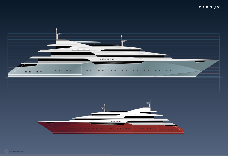

My thread number 4 with designs will look like the other three, some new dream designs, some older that I find in my files and some from our production of fast commuters. There will be a new such model this year again.
But before reality starts on Monday I have found some time and created this 100 meter concept. The idea is mainly to keep her lines more like a yacht than a ship, no big heliport, just a pad on the foredeck. Instead pockets for up to 50-foot tenders each side.
/Lars

seems like the floors are split-level, i did some rendering like that (other design/split level) some month ago
looks definedly hot

Yes Jannick, she is split level built around a central atrium. The red guidelines are the forward part and the blue is the aft. This allows for the tender bays to be higher. Also positioned a little more high and dry than usual.

Is that segment just above the anchor door openable for observation of anchor set operations?

I did not notice any huge comm domes, just those slim pillars/poles.
Is this the new trend now, i.e., having the comm domes hidden or with low profiles?

Thanks all, yes Arnie, the domes are totally or partially hidden behind the fins.
They can be leaning out as an F18 with domes in between, or leaning in and be covered by GRP where all antennas can be without domes of their own.
And Codger, these are open mooring stations as the deck above has a helipad.
Good observations!
