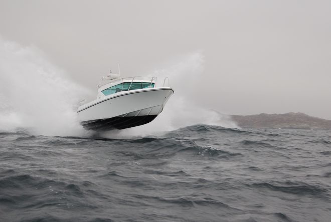

I just receieved this picture from our Norwegian retailer testing out the new D29 prior to be delivered to a client. I am sure they will run the 50-footer even harder...
AMG is offline   Reply With Quote

Hang on!
Oh my gosh!
What a great shot...love it.
Very good looking and robust boat.
Hope the guy at the helm can keep up!
