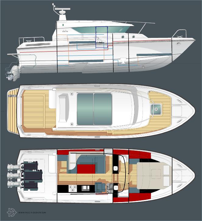

At the boat show we got some feedback on the D33 design...
It seems as more people than we thought are more keen on speed than economy and want twin engines over a single. So she is now D34, extended by four inches and with deck and superstructure raised by three. The major changes are the dinette which now accommodates two forward facing passengers and the second cabin has got the entrance moved aft which allowed for a separate shower room. On top we have added a fixed glassroof aft of the electric hatch.
This means we can start with the hull production, 3D-files are ready for the CNC-robot. And pretty soon we will also make the deck files. I just have to consider some minor tweakes....

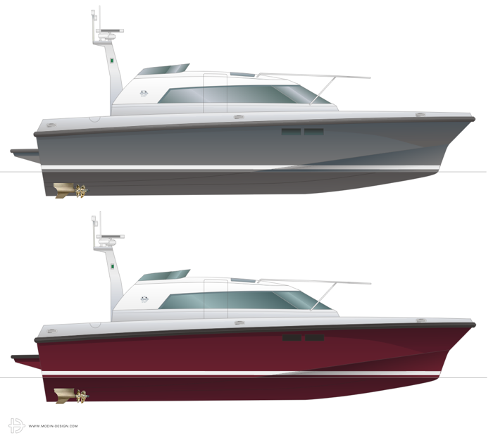

For the coming 50-footer I have considered to use the "grey-line" design I showed in my first thread on YachtForums in 2004. It is hard to know if this design would be better received on a 50´ than using the reversed windscreen design as on the D34 above...?
What do you guys think, will this design be the right for a 2010 50-footer?

Old 03-23-2008, 08:11 PM   #64
brunick
Senior Member
brunick's Avatar
Join Date: Jul 2005
Location: flensburg, germany
Posts: 502
have you tried to design the grey design with a reversed windscreen? i think that could look very cool - maybe you'll have to stretch the roof a bit forward but that would give some head space too

Old 03-23-2008, 10:27 PM   #65
Codger
YF Wisdom Dept.
Join Date: May 2005
Location: Western Canada
Posts: 935
If the functionality of the windscreen design was valid in the other models why would it not be just as valid in the 50 footer?

Old 03-24-2008, 05:31 AM   #66
AMG
YF Moderator
AMG's Avatar
Join Date: Jul 2004
Location: Sweden
Posts: 3,257
Thanks Jannick, maybe you are right, I´ll give it a try.
Codger, this is why I am hesitating, a production boat for about € 1 million must be appealing to enough people before we invest in all the tooling. The workboat style windows are not what you find from other builders why people may not be prepared to buy them..?
Since I can not use a stepped hull for the IPS, I was looking into this design instead, but perhaps I can still make a reversed windscreen. We´ll see pretty soon..

Old 03-24-2008, 07:31 AM   #67
nilo
Senior Member
Join Date: Feb 2005
Location: Istanbul
Posts: 499
Lars,
My opinion, the name of the game is to be contemporary and different. That is why Apreamare has changed style further. There are too many design with raked pilothouse windows. Your design might bring some new flair and attraction.
nilo is offline   Reply With Quote
Old 03-24-2008, 08:44 AM   #68
AMG
YF Moderator
AMG's Avatar
Join Date: Jul 2004
Location: Sweden
Posts: 3,257
Yes Nilo, it is just a matter of how different you dare to be...
As an example, Fjord made a 40-footer that reminds quite a lot of my "Greyline". It has received attention and design prizes, but I don´t think they sell very well? At least not compared to our 40-footers. So maybe I should continue that style, it is just that it becomes a little boring doing the same lines after six years...
I made a quick attempt of reversing the windscreen of the boat above but then I had to change the bow since it looked too strange. I already have a "white" 50´prepared that I will not show yet, but I think it looks better than this one...

Old 03-24-2008, 12:36 PM   #73
OutMyWindow
Senior Member
OutMyWindow's Avatar
Join Date: Jul 2006
Location: (Coal Harbour) Vancouver. BC. Canada
Posts: 878
Personally I think that the windscreen design is a “signature” of the model line, and changing it in order to potentially appeal to a broader audience could be misleading, as the marketplace is full of “look-alike” boats and you could get lost in it.
Assuming your expectations are modest and your not planing on competing with the mass market builders out there, having a “Swedish/Modin” style is an asset and should appeal to clients that want to distinguish themselves from the pack.
Maybe as a suggestion, slightly reducing the “rake angle” of the windscreen with the greater size of boat may be a compromise but still give it brand recognition.
OutMyWindow is offline   Reply With Quote

Old 03-24-2008, 01:09 PM   #75
AMG
YF Moderator
AMG's Avatar
Join Date: Jul 2004
Location: Sweden
Posts: 3,257
Kelly, your observations are right, there has to be some surrounding support lines with a reversed windscreen to make it look OK. The transom is open with a hatch covering the cleats each side. Not much space for additional design features. And in fact, my design was presented to the guys building the Fjord, long before they started with their new line...
Outmywindow, I appreciate your advice to not follow the pack, it has worked well for us and we are pretty established here today. My question is what will happen on new markets, but since they are much bigger than ours, we just need a small percentige to be happy.
Codger, this boat will be owner operated. With IPS and joystick it would not be hard to drive and I think we will find our clients among pretty experienced people.
Finally, what I would buy..? I browsed through some magazines to find something, but even if I got any boat there for free, I did not find any production boat, regardless of size, that I would take.
In the past I liked the midsized Bertrams or Hinckleys, but they are not up to date and the Wally´s are a little over the top for me. Hard to please..
AMG is offline   Reply With Quote
