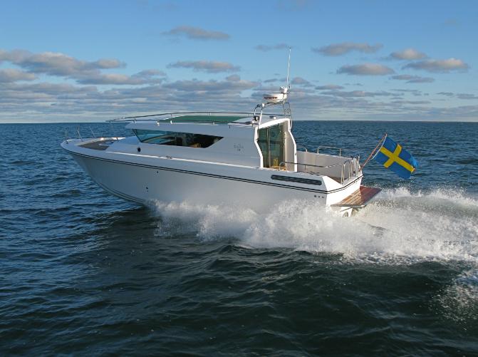

Just in time for the Scandinavian Boatshow in Stockholm, our new 34-footer was launched. We started this project seven months ago which is a rather short time for a new model, but the first sea trial across the Baltic was successful. The top speed was 38-39 knots with a Volvo Penta D6 370 hp and she was using around 1,6 l/nm at 30 knots.

Does having a stepped hull lose it's benefits beyond a certain length?
Codger is offline   Reply With Quote
Old 11-04-2008, 09:30 AM   #172
AMG
YF Moderator
AMG's Avatar
Join Date: Jul 2004
Location: Sweden
Posts: 3,257
Quote:
i don´t think so, but with certain propulsion, such as waterjets or IPS drives. This is because the step is creating air bubbles and both jets and IPS needs "clean" water.
