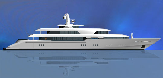

    I have attached a few renderings of a 70m (230ft) superyacht concept that I have been working on.
    I have been involved in yacht design for a couple of years, but typically the things I doodle tend to be a bit outlandish and impractical, so I decided I should make an attempt at something more conservative to add to my portfolio.
    This was only intended to be a quick study, therefore much of it was designed "on the fly" whilst I was building the model, and I am not totally happy with the proportions in profile, but can't quite put my finger on the problem.
    Similarly, I have not done a GA as such, but assumed a typical layout for a vessel this size - "technical spaces" (such a useful phrase), storage and services on the lower deck, crew & more technical spaces up a level, the main deck with saloon aft, guest cabins fwd, owner accommodation and bridge above that, and a sundeck with helipad on top.
    Thanks

    I can’t quite pinpoint it, but possibly enlarging the upper deckhouse would help bring balance to the overall structure. In the side rendering, the skylounge deck tends to overpower the fly deckhouse, resulting in an elongated profile that is further accentuated by the swim platform extension, which in itself is longer than average. Not that any of this is bad. It’s certainly better then a Wedding Cake yacht. For our readers that are unfamiliar with the term, "wedding cake" is often used as a negative connotation that refers to a yacht being too tall, or having too many “layers”. Not only does this look unbalanced, it looks inherently unstable. A classic example of this is Feadship’s Wedge II or Utopia (see below).
    That said, your work, both artistically and mechanically is excellent. Welcome to YF!

    I think that is where the problem lies. The upper-most deck house probably needs to be a bit further forward, and a bit taller.
    I'll probably rework some areas in due course - it was supposed to be a quick study after all.
    I agree that they are not the most balanced or sleekest designs on the water, but they have their merits. Wedge II, particularly, I think is quite a smart looking yacht, with some very interesting details.
    Thank you for saying so.

    Not too bad Peter, here are my comments (please don't take them as -ve, more constructive and it's also just my personal tastes too..)
    Ref the design -
    1) Your bow line (in profile) has a kink at the knuckle - would look much nicer (imo) if it was smooth. I usually spend a complete day just modelling the hull/bow, it can be a really tricky area.
    2) The bulwarks around the fore deck look a little high, I would try to keep this at 1m or a little more (so maybe raise your foredeck instead of dropping the shear line).
    3) The top side of your hoods look a little feature-less and are possibly too chunky up forward. One way to combat this is to keep a sleeker/shallower hood line and where you need to keep a 1m height bulwark (for the walkways) just model in a local 'upstand' that blends back into the hood.
    4) I personally think that your hoods look too elongated in plan too. I think if you use the shape that you've got for the sundeck bulwark (more of an arc shape) and copy that down for each hood.
    5) Possibly some sort of 'styling relief' lines along the coaming sides (on the tiers above the main deck) or reduce the height of the bulwarks and then make it back up with some nicely styled railings, maybe teak capped??
    6) The heli pad looks a bit too small, I think it could do with a little more length imo.
    7) The aft overhangs don't seem to line up as nicely as the front hoods and the angle of the transom 'pod' seems to fight with the other lines in that area.
    8) I would have the transom platform wrap around the side of the hull and travel forward untill just fwd of the garage doors, this will act as a handy fender.

    I like it too. As to your issue with the profile, perhaps its the fwd coachroof tops being too flat and straight for too long ? The general shape of the coachroofs could be curved off far more in profile resulting in less of a flat surface on top. To me, any issues in pure profile disapear in the perspective views, so Id put it down to lack of surface curvature in profile. However, its your baby...I for one hate offering personal critique against fellow designers unless prompted or if has an obvious fault. In your case you seen to know what you are up to and its an attractive and powerful overall design, the rest is down to personal taste. But I know what its like when you have something that has just a wee element that you are not quite happy with but cant put your finger on...in my case I sometimes dont solve these issues until several are built and afloat by then its too late and its onto the next project.
  12. KCook
    KCook Senior Member
    Jun 24, 2005
    1,159
    Phoenix
    CODOG's comments prompted me to review those forward coachroofs. I agree they look a bit "fat" in the one profile plan, but are fine in the perspective POV renderings. In those renderings it's also clear that there is a lot of curvature in the section outline to these roofs. Which is quite nice. But that one profile offered does not hint at this curvature. Rather it leaves the sides of the roof with a slab like appearance. So possibly the real problem is in the rendering of the lighting in the profile view? Not the actual design?
    Kelly

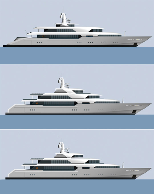

    So long as it is productive in some manner, criticism is valuable, as is knowing when to listen and act on it, and when it can be overridden. I appreciate that a degree of discretion is polite though.
    I think it was the fact that it seemed to look ok in perspective was a bit of a red herring in that respect. I have sketched out a revised profile, and I'll neaten it up, resize it etc, gauge some opinions.

    I've made the upper deck house a bit more substantial, and moved it forward slightly, and tweaked a few other detail which frees up a bit more deck space aft too.
    It makes an awful lot of difference I think
    I actually got round to measuring it too, it's actually 76.5m. Oh well.

    Definately made a big difference! The second design is the one I'd go for.

    Yes that definatly made a difference.Though I still like the back deck of the first one. If posible could you make a rendering of the second one and have the 1st back deck on there.

    Third profile down looks hot. Shame you had to cut 7 metres off her stern though, the original sloping aft 'ears' looked great. Whats 22 odd feet to a surveyor anyway.

    It looks nice; maybe it will fit better on something a bit sleeker.
    I've remodelled the 3D version as per the second profile, I'll put some renderings up sometime.

    73m now - the incredible shrinking yacht!

    Wow! I think the new stern is an improvement. Still a little uneasy about the front of the superstructure. The vertical window wall on middle of the 3 decks (including sky lounge) seems too bold. Though that may just be me, I see exactly the same issue in many existing yachts. Anyways, I'd be tempted to play with raising the top of the bulwark in front of that window, enough to mask the window's bottom a bit.
